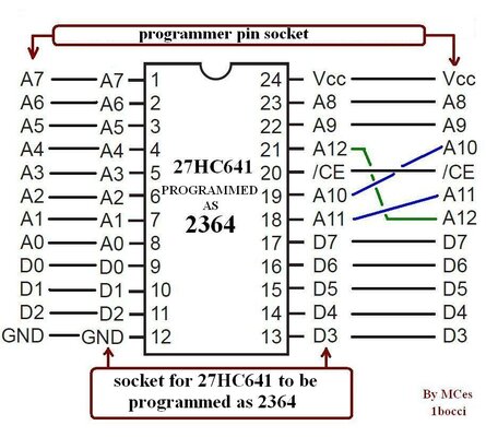

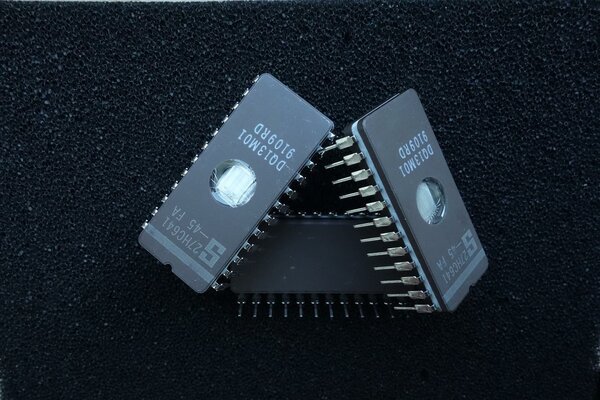

27HC641 EPROM,if specifically programmed, are pin compatible with 2364 ROM.
This Eprom can replace the old Commodore 8K ROM in VIC20, C64, SX64, 1541, many game cartridges,ecc....
A lot of Commodore computers, drivers, cartridges use the 2364 ROM!
The only differences between 2364 and 27HC641 are 3 address pins swapped, consequently it have to be programmed through a converter-socket (into pic) OR it has to be programmed with a manipulated ".BIN" file that exchange the address pins.
Normally this device is NOT programmable with a cheap universal programmer,
so I can program it (correctly) for you.

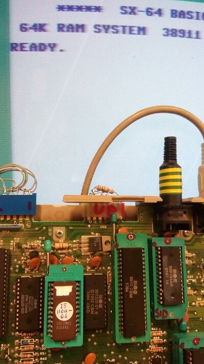

I can program 27HC641 like pin compatible 2364..... but what's possible to do with this ROM?
- Spare parts ROMs
Obviously they can replace every ROMs 2364: kernal/basic/games for VIC20 and C64, but also the 4k character generator for C64 (NOT for VIC20..), the ROMs inside the drive 1541, ecc...
