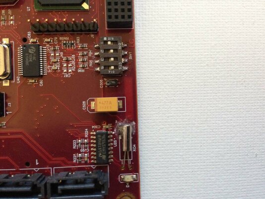

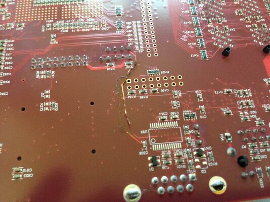

So, what do the scientists think of this? I was carefully looking over everything and then slipped the board out holding it in my fingertips as you so and I flipped it over and saw this. A damaged Track? I might ask ACube what exactly is affected here.
The other picture is just another snap of another area of the board and wondering what sort of resin is that and should I worry? The entire surface of the back of the board has what looks like a milky resin in various concentrations. It might be perfectly normal or a consequence of being in a humid climate, no idea.
Anyway, like I said, lets not jump to any conclusions :thumbsup:

Ummmmmmmm.... Very very bad . i dont think this is an acube fail mate.something goes wrong after some (desoldering??)hardware modding I think.
ok I got a email from Enrico :thumbsup:
he said:
About your question:
J17 is the internal USB port of 440ep CPU.
Maybe the old customer made wrong connection to this port.
I think probably he damaged only the 5V track and you can rebuild it
soldering a wire from c308, the vias before it and the Pin 1 of J17.
Anyway firstly remove the damaged track and try to power up the board to
check it's all ok.

It has been confirmed the serial line is affected by the damaged track, ACube recommends I send the board back to them because chances are the U22 needs to be replaced

Now I read the thread I see that I did connect a USB header around the wrong way on J17 in the past but I did not notice any damage at the time and the system worked fine. The GND and VCC would have been swapped to the card reader it was going to and this would have probably burnt the trace.
I honestly did not realise it happened but now it makes sense how it happened. I did use the serial port before I plugged in the card reader but not after so I never checked if the serial port was working. Had I done this I would have found out.
