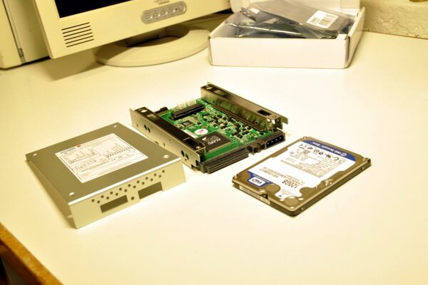

You can get SCSI to SATA, I have a 120GB 2.5" SATA hard drive in my A4000 at the moment. ACard make lots of nice adapter cards/boxes but they are on the expensive side.
