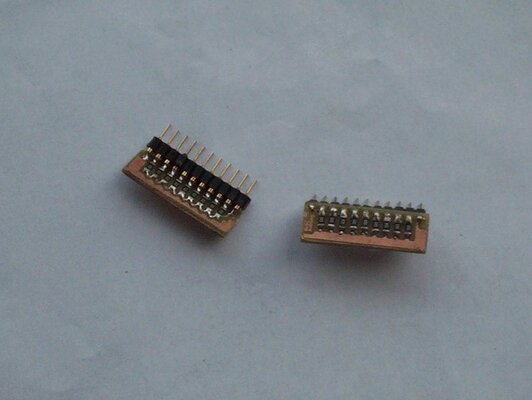

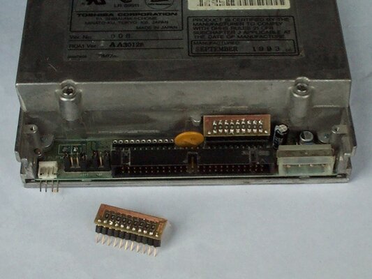

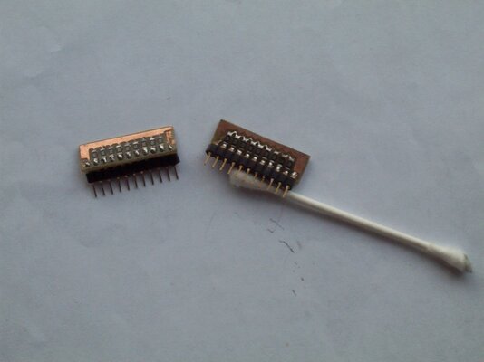

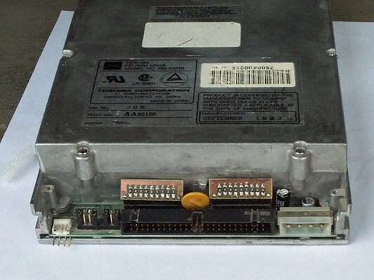

Hallo,
just if you are curious, here a couple of 'Terminators', made by me, for a SCSI CD-Reader, for my Amiga 3000D. Without them, attached this device (the reader, not the terminators) to the internal SCSI port, at the end of the chain, the computer hang during boot; with this parts, the computer start and the system recognize the device correctly.
Please, pay attention that this parts are not for the motherboard itself, but for the CD-Reader, even if the motherboard accept similar parts as internal terminators (but they are not needed if the internal chain is terminated at one end and the SCSI external plug, a DB-25 female plug, has an active terminator, or there is one or more devices attached and the last is terminated!).
Regards
Stefano
