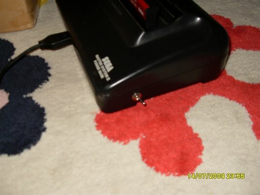

Ok so its not Amiga related nor is it a massively complex mod but hey its not very often i attack a machine with a soldering iron and it still work when i'm finished. Well this works and so does my hack! I'm very proud of myself lol
Ok so the aim was to fit a toggle switch into my Sega Master System Mark 2 to toggle between 50hz (Pal) and 60Hz (NTSC).
The main reason for doing this was because i'd been reading and apparantly Pal games run 17% slower and have a top and bottom border where as the NTSC has a full screen and runs at full speed and i wanted to see the difference and it didn't look that hard to do it.
All i had to do was lift a leg (Pin 57) from the graphics chip and solder it to the middle leg of the toggle switch and then find a +5v and a ground and solder each of those to either end of the toggle.
I will be honest and say its lucky i have 2 SMS consoles as my first attempt at lifting the pin from the IC just snapped the leg off. Console still works but am now unable to try the mod.
Second attempt was a lot smoother, leg lifted, tinned and soldered to the switch.
+5 found very close to the lifted leg and ground taken from a capacitor situated next to the IC.
Again I will be honest and say i didn't find the +5v and ground myself as i don't have a multimeter and wouldn't have a clue where to start even if i did.
I located the +5v and ground using the tutorial i was following to install the switch.
Anyway, all points soldered and switch mounted to the side of the machine. On test all is working perfectly.
As the toggle switch is "break before make" i can even switch without turning the machine off.
Some piccys if anyone interested.

Nice work mate, thanks for the photos and write up. :thumbsup2:
Does it make a significant difference?
I love a good photo story of people's work, I only wish more people would post up their little projects. They're always interesting to read about and can sometimes provide inspiration.

thanks for the comments guys.
It is very noticable when you switch it and to be honest once i'd played Alex Kidd in Miracle World at 60Hz ntsc i didn't want to switch back to pal. Everything just sounded a lot better and seemed a lot smoother.
