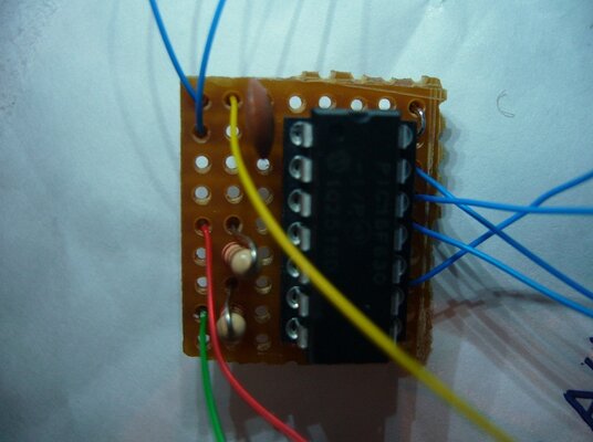

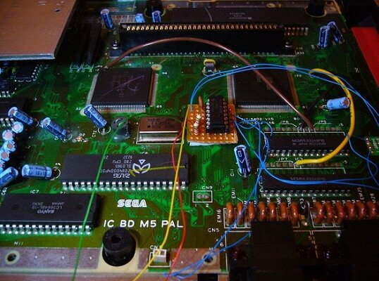

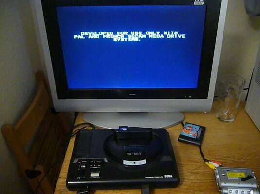

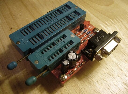

Just thought I would upload a few pictures up of my latest project.
This mod enables me to select PAL/NTSC and/or the region Euro/Jap/US on my megadrive without the need to drill holes in the original casing for switches.

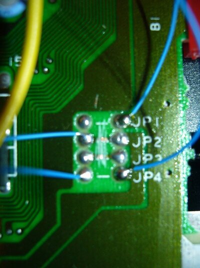

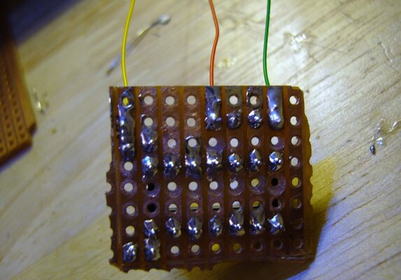

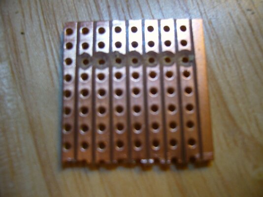

To achieve this, a PIC 16f630 is place in line of the reset switch so that the switch can be used to send commands to the PIC to instruct it which mode to place the megadrive. All in all its quite a simple mod, with a few traces to be cut and a small circuit board to be constructed.
