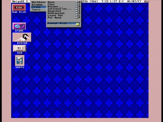

so...idiot question of the year. how do you format a floppy from workbench?
Left Click on Disk, Right Click for Icon Options
Use System Format Tool

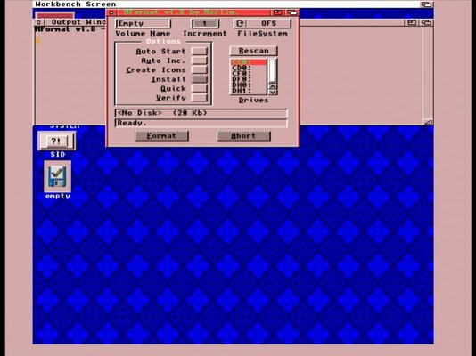

OR MFormat
