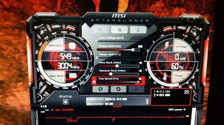

Cheers John. I'll look at msi afterburner. I thought the fans were automatically temperature controlled?

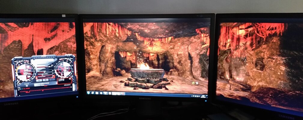

Geez I can't beleive how much dust builds up in just 2 months! I've given the whole system a clean out and also swapped the GFX cards round so that the load is on the other card now, maybe that will help a bit. I also added a 120mm fan on the side window directly blowing onto the two GFX cards. I've downloaded MSI afterburner and at the moment the main GPU is idle at 35 degrees/c but not done anything intensive yet.

I look at the speed profiles, so I guess the auto fan levels don't really give much speed vs temp as just putting fan at 50% for idle has brought the temp under 30, what sort of curve would you recommend?
Seem to have got things stable, I hope! Never heard the fans get this loud before so I guess they were running in quite or some eco mode?

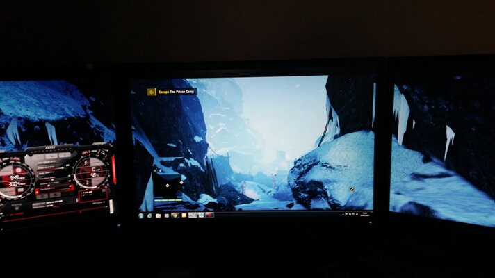

The MSI Afterburner works really well, at approx 75% Fan speed I get stable 60C under full load, tested with my most demanding game, Far Cry 4! Even after 1hr it doesn't go over.
Time for some lunch, this damn prison is really hard to escape!
