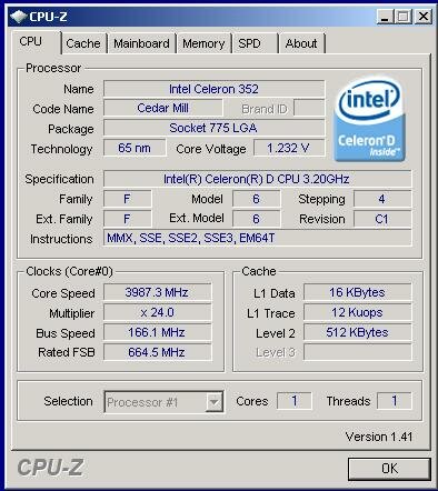

I can get *just* under 4Ghz out of my Celery D352 on an Asrock 775 DualVSTA board; you don't necessarily need a badass motherboard to get a successful overclock. My rig was the subject of overclocking discussions at OS-UK, which is where I first reported getting 4Ghz. Careful cooling and good quality memory helps a lot; I am using Corsair 667Mhz memory.
[attachment=0:26p0xch5]Overclock2.jpg[/attachment:26p0xch5]
Why do I foresee a 'peeing up the wall' contest developing in here....? :mrgreen:
