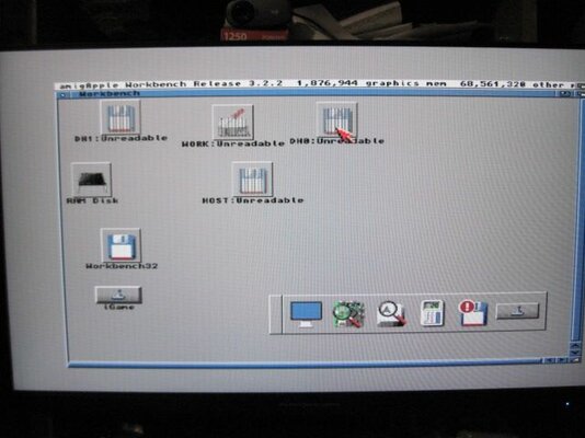

I have a problem with the SCSI on my Warp Engine 060-80Mhz in my A3000 tower with 3.2.2. I have a ZuluSCSI with 3.2.2 OS and roms I seam to be able to make large partitions over 4GB using the 3000T on board SCSI and works fine if I move the Zulu card over to my WarpEngine SCSI with the onboard one no longer hooked up it will not recognize any Partition or Drive over 4GB.
Why would that be and is there something I need to change with the WarpEngine or the device drive. I would think it would recognize them. I shows the partitions or Drives under 4GB
Any Ideas or help from this great AMIGA Team.

I am using the exFAT format and it works fine on the 3000T with on board SCSI all partitions show and work perfectly It is just when i swap it over to the WarpEngine scsi it has this limitation of only the boot partitions is active, See photo of when it is hooked up to WarpEngine Scsi..

When using a WarpEngine accelerator, please remember (from within HDToolBox) to edit the partitions, select the "Direct SCSI" check box, save the partitions, reboot and all will be fine.
Well I got info from A1K site and all I had to do was to check the Direct SCSI Transfer in the partition drive setup and that made where are the Partitions are now active and working at 7 GB
Hope this helps others as well.
