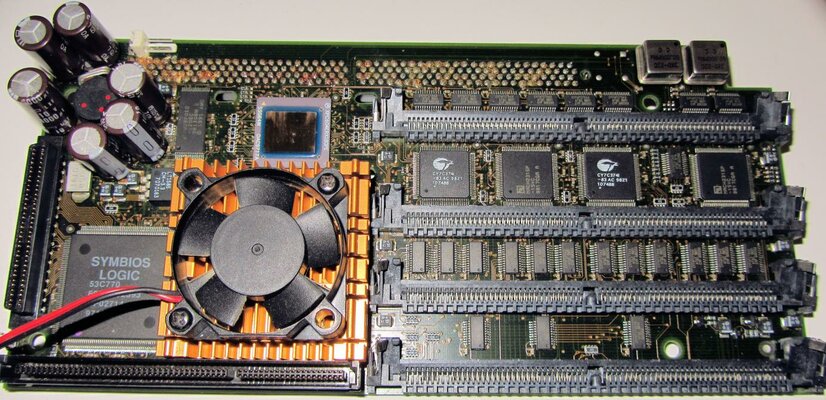

today i will make photos in hi quality of my cyberstorm ppc
OK, it might be kinder to post thumbnails or just links to the large resolution images as opposed to posting some 18MB of photos on the forum.
Anyway, regarding the CSPPC socket (the photos don't really help) you can usually check this yourself. Have a look at the socket testing steps in the guide I wrote here at the top of the page.
In summary, if you can make the board boot with pressure on the 68k CPU then the board is repairable. Sometimes takes pressure on a corner or a side, depending on where the fault is.

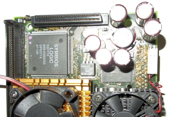

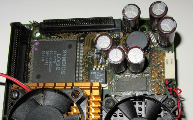

I finally found a "never overclocked" CyberStormPPC (hardware rev.2) PPC 180Mhz and 060 but the Ultra-wide SCSI 3 interface is not working...is not recognize anything. cybppc.device is 44.71.
I tested with cables and devices perfectly recognized on a Ultra-wide SCSI 3 PCI PC interface.
There is a lot of corrosion or something on the soldering near SCSI component and on the CPU slot. Look at the pictures.
Is somebody has experience with someone how repairs and can share feedback.
