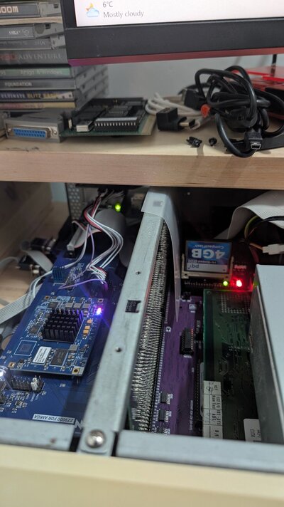

HI Guys,
I have a newly built board which is amazing but I am having weird problems with cf cards.
I get the boot section working perfect but the secondary partition keeps throwing up sofware errors.
I have set the max transfer to 1fe00 as per instructions and tried other 4gb cards the one I am using is a lbd hi speed 120x the transcend 133x is just not running. I setup the disk in amiga Hdd setup after cleaning it in windoz to make sure there is no info left but the strange thing is once I create default setup using 3.2 and ffs the work partition is still intact and still throwing up software errors. I have never had problems with the CF drives before and wonder if its something I have screwed up and the old mother boards just get on with it?
I think for the last 20 years of being lazy I have gotten away with a lot so looking at the many setup web sites I am just getting old and slow. I believed that with OS 3.2.2.1 and the setup from 3.2 using FFS that would be OK!
HI Guys,

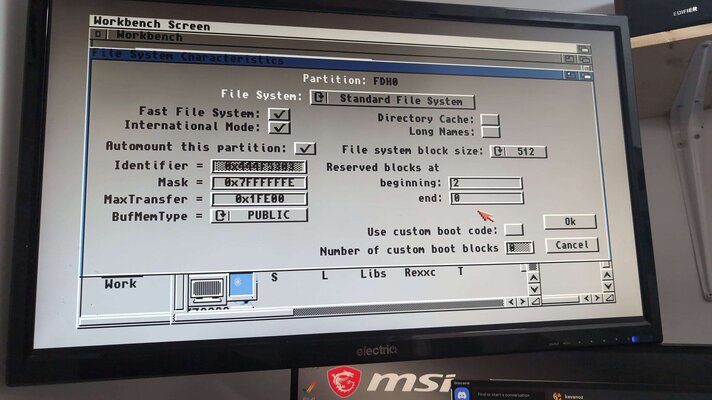

I am currently using AmigaOS 3.2.2.1. Now usually on this version the max Transfer is usually setup as 0x00FFFFFF as default. I also use the “PUBLIC” setting in HDToolbox that comes with AmigaOS 3.2+
On older HDToolbox such as 3.1 and 3.9 then the max transfer is usually setup to 0x001fe00. Now this should still work but is deemed a less speedier transfer method these days. But safe.

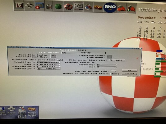

I do tend to use PFS3 Version 3.2 (Version 20.0 Beta 5) from Toni Willen’s thread over on EAB with great results.

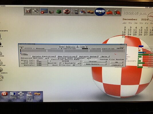

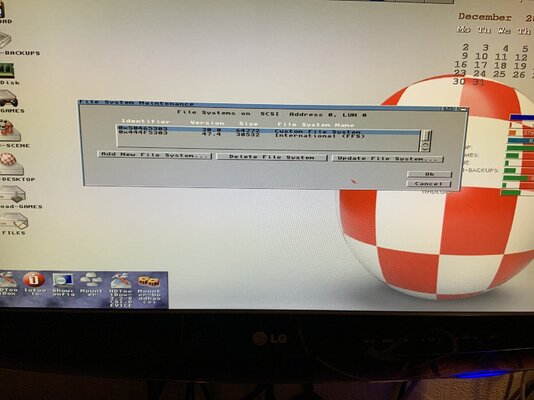

It maybe worth posting up a pic or the full settings in HDToolBox of your full settings for analysis. Which version of FastFilesystem are you using?
Edit:
Some pics from my HDToolBox for reference:

just an idea it is setup by default
the Acill is an amazing board and looks great with all the new gals and my original Customs I am thinking it is my fault. I normally use the Elbox fast ata v6.

I lost my Z3660 due to a faulty Zturn board so waiting on a replacement turning up.

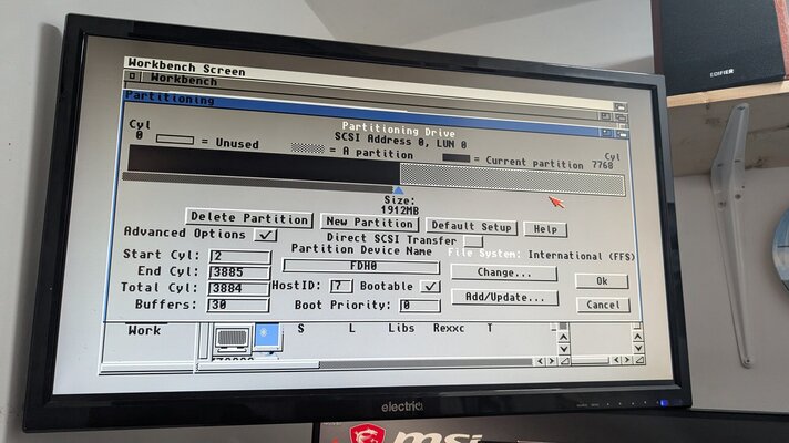

If that was the case. Then in your startup-sequence it will be referencing it. I.e C:ATA
I would edit this out.
HI Buddy, sorry been busy with other projects
