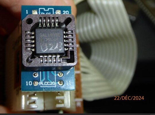

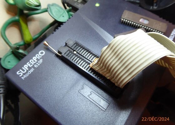

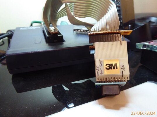

Frustrated by not being sure that the right version of the Gal was in U213, I made a DIY to test the GALs directly on the Amiga CMs.
For this realization you need a 3M 22Pin control adapter and solder in reverse the Pins 1 to 20 for the 16V8D PLcc20 (others can also be tested).
In this way you can directly position the PLcc20 adapter on the Gal16V8 in U213.

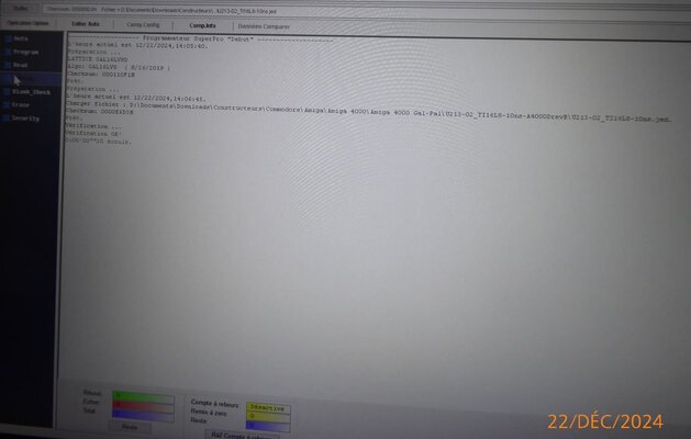

1- Load the .Jed U213-02
2- Launch the "verification" option.
If it's Ok, we have the right version, otherwise we have to reprogram the Gal or replace it...
It's a simple and effective system to check the versions installed on our Amiga motherboards...
