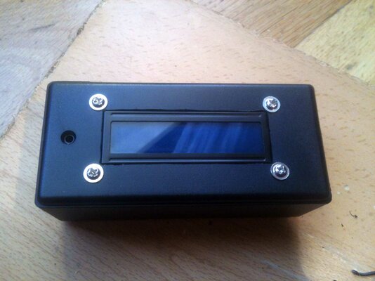

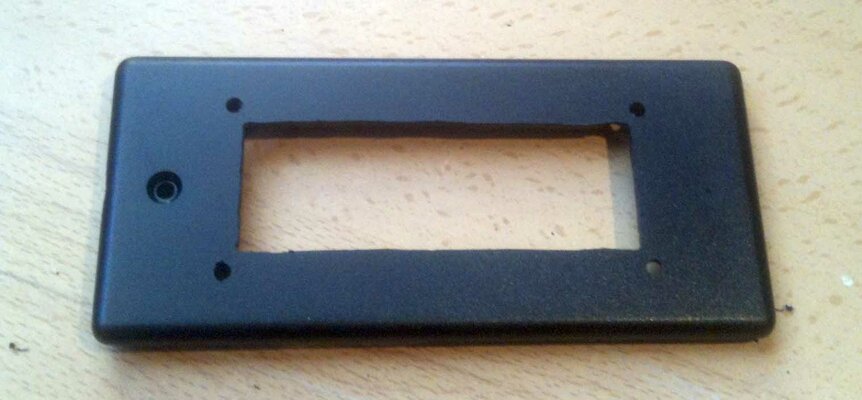

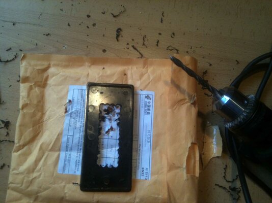

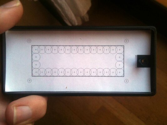

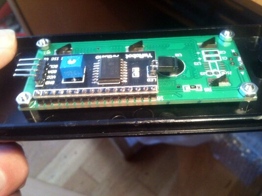

First batch of PCBs shipped yesterday from HK, should arrive in 2-3 weeks.
Meanwhile I was making the rectangular hole for LCD with the help of a guide for centering holes.
The finish is not very polished but my mechanical skill are limited, and the only tools: drill and lime.
Must be very carefull to hold the cover when drilling.
Will look for black screws or put a black vynil to cover them.

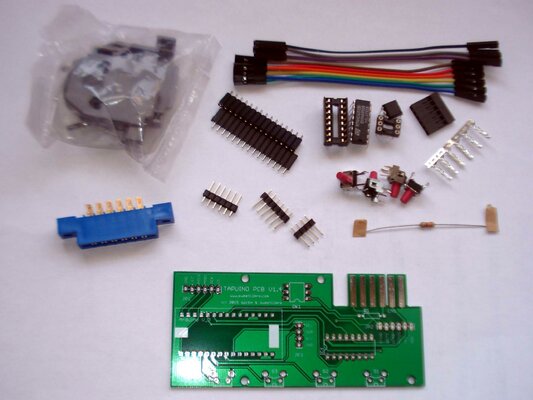

BOM list for Tapuino
Well appart from the PCB, Arduino, LCD & SD card shield and a piece of 6 pole cable, you will need:
PartQTYValue
IC1174HC4052
SK1116PIN DIP SOCKET
SK2140 pin Female pin header (Use 2x15 for arduino)
JP1,JP2,JP3140 pin male pin header (Use 6+6+4=16 pins)
XP1,XP3140 pin Female to female dupont jumper wire (Use 6+4=10)
XP216 Pin Dupont Cable Housing Female + PINS (For JP2)
CN21Card edge connector female 2x6 pin, 3.96mm (For C64 datassette port)
CN2C1DB15 plastic cover for CN2
OK11optocoupler 4N35
SK316 PIN DIP SOCKET
R11Resistor 330 ohms 1/4W 5%
S1, S2,S3,S44Tactile switch 8.35mm RED RS 758-2007 DIGIKEY 450-1658-ND
All this will be included in the kit.
The switches can also be the SKHHLSA010 from Alps or DTSA-65R from Diptronics.
The box recommended for this is Supertronic PP9, I have put a link in the first post.
The kits with box will also include the screws needed to fix LCD and PCB to box, but you need to drill the holes for LCD, buttons, cable & datassette input.
I need to receive the PCBs and check.
I have some card edge connectors (CN2) for C64 datassette port , as I use them for a datassette emulator kit (MP32C64).
Also I think I have some spare switches, but need to check.
I think that's all, but not really sure.
