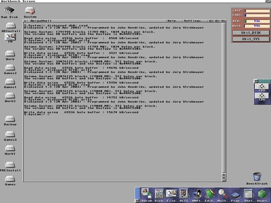

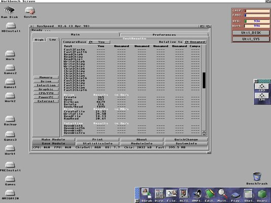

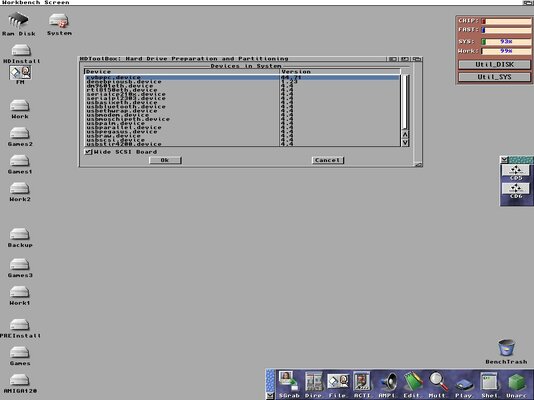

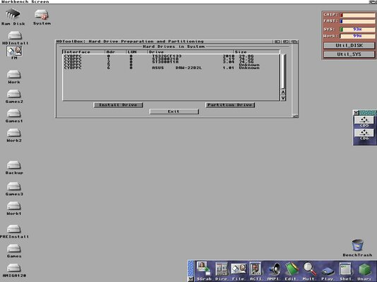

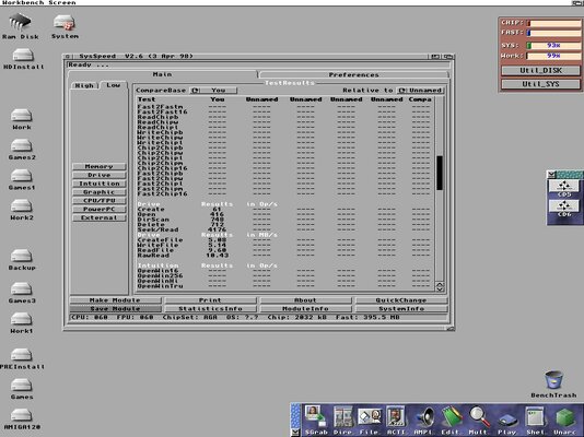

merlinkv Active member Joined Oct 15, 2009 Posts 4,114 Country Ukraine Region Kyiv Oct 15, 2011 #22 Well, as promised, some pics..... SCSI ID0 - ID1 - ID2 SCSI ID5 - ID6 All adapters & Firmware The ID6 has the Power Terminator set to ON

Kawazu Member Joined Oct 22, 2010 Posts 572 Country Sweden Region Åmål Oct 15, 2011 #25 Have you noticed any speed difference when you change the reselection and mount settings? I have not noticed anything at all
merlinkv Active member Joined Oct 15, 2009 Posts 4,114 Country Ukraine Region Kyiv Oct 15, 2011 #26 Hi, Not, this settings don't affect the overall speed (in my systems). But the CSPPC SCSI is a bit "temperamental" one, and I found is better -for stability- to set all config options in the CSPPC Bios for each device.. ie: All HDD's have the "No Removable" option, but the DVD's are set to "Removable". Also the unused ID's are set to OFF Kawazu said: Have you noticed any speed difference when you change the reselection and mount settings? I have not noticed anything at all Click to expand...
