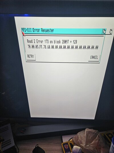

Hi Guys
Recently bought a TF534 for my CDTV with new roms, got it all installed and upgraded to Kickstart 3.2.2, got the insert disk screen up and I have a 32gb CF card but I am so confused what I should be loading onto it, I tried an img file from Amiga Games Selector ...which is really what I want but it doesn't appear to work. Can someone please help me out?

You shouldn't get insert disk screen, but CDTV welcome screen. Seems that your extended roms doens't work.
But genrally, you would need to install operating system then needed apps. Youtube might be best way to get help for that. Search something like "amiga set up hard drive" etc.

Getting this error, ordered a new CF card, anyone know what's going on?

Hi,
Was Your card swapped out underway? I'm pretty sure I've sent You TF536 not the TF534....🤔
Im not even sure will TF534 work on CDTV..
Are You using it in A500 mode? But why? This card I've sent You fully supports CDTV mode (with OS2.35 ROMs - that's why these are needed)...
Normal OCS system should be installed on it (CDTV is an A500 on steroids)..
Not sure what is it, need take a look to say something about...
Is this card working on other systems? Seems that the Filesystem (PFS) on Your CF card got corrupted.. Since You have installed KS3.2.2 - I recommend You to use it's Fast FileSystem and move away from PFS, it just work more reliably, many issues are corrected in this release..

I am so sorry yes your correct it was a TF536. Most of my errors are down to not knowing much about the Amiga system apart from playing it as a kid.
Can you be a little more specific on what I need to add to a CF card please? Thank you again
Well, if You don't have a clean setup of OS3.2.2 - You should definitely make one and install MMULibs..
Actually You can find a million detailed videos on YouTube how to install and set up fresh 3.2.2 system...
