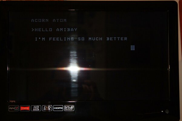

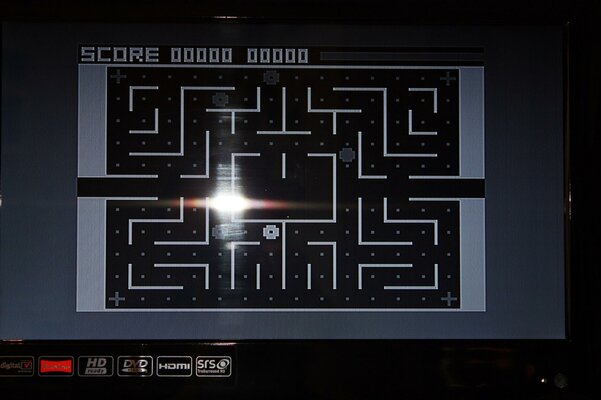

Finally we tuned the TV in and were greeted by a rolling Screen with the prompt "ACORN ATOM" in the top left...
At this point my Interest shot up & we adjusted the Frame hold on the TV to stabilize the Picture...
Now I was hooked, this box of circuits would respond to our written english commands and communicate back via the TV .....And so my journey began...

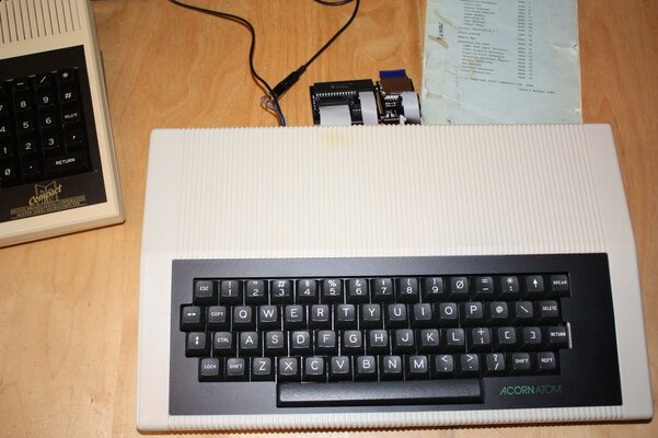

The System we built was the Basic 2K RAM and 8K ROM Atom and evrey other saturday we would run into the town centre to buy another 1K of RAM and begin to unleash the HiRes Graphics Modes....
That my friends is why the Acorn Atom is so special to me and I didn't hesitate when Iain asked me to restore this beauty...

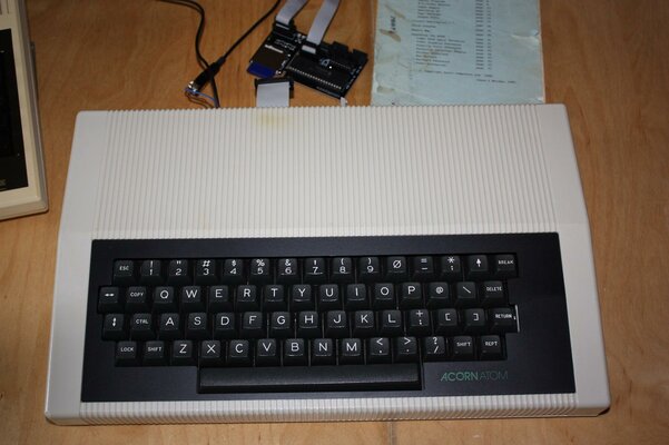

Note --- The little Blue Technical Manual in some of the Pix, that's the original one that I used and followed back in 1980 and it served it's use again this time around too...

Now bear in mind the footprint & design of the Atom's Aesthetics was one of the first of it's kind, and indeed most Home computer's (apart from Sinclair) borrowed and expanded on this type of enclosure, just look at the C64, Dragon, Amiga....etc
The Atom has some really wierd design constraints but this was the day before ULA's and PAL's etc..everything is built up of discrete Logic and off the shelf processors....

This was an odd choice as this VDG is a 60Hz NTSC device (remember the rolling screen I had in 1980)
When used in a PAL CoCo or Dragon, The VDG is stalled at the end of every frame & clever descrete logic adds an extra 24/25 lines to the display to produce a Pseudo PAL Signal.
Although the Atom did not have Colour as std, Acorn did produce a Colour Board for it which provides exactly the same colour / res facilities as the CoCo & dragon...
Another nasty side effect was Noise on the Screen when the CPU needed prolonged access to the Upper Text RAM (See Later), effectively blocking the 6847..

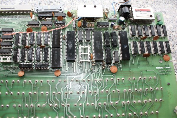

All the RAM on the Atom is Static Ram, it does not need refreshing, it uses 2114 SRAM's which are 1K by 4bits so two are needed for an additional 1K of RAM.
The older version of these chips was also extremely power hungry, ie 100mA per 1K, or 1.2Amps for 12K
The later devices cut this down to 35mA per 1K.

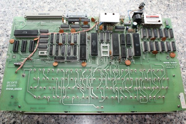

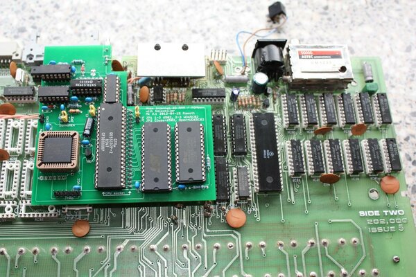

You can see Iain's board has a mixture of old & new type SRAMS...

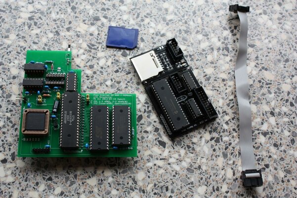

Atom development on the Stardot forums is certainly active and some of the guy's notably Prime & SirMorris have developed some nice addons...
Prime has designed and produced the ROM-RAM board...
It provides full ROM capacity for the Atom but also 32K of RAM, this means the Lower Text 6K can be removed from the main board, but the 6K Upper or Video RAM must stay.
Most importantly this board contains a noise killer circuit which effectively doubles the clock speed of the Video RAM and removes ALL noise from the screen, it also speeds up processing too..

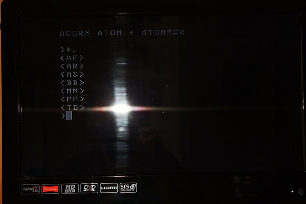

Sir Morris produced the MMC2 Interface which has superb firmware on board and performs amazingly.
The firmware is flashed ready on the Rom-RAM board...

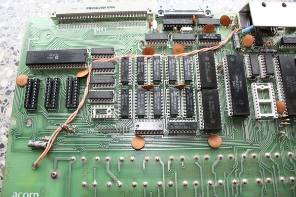

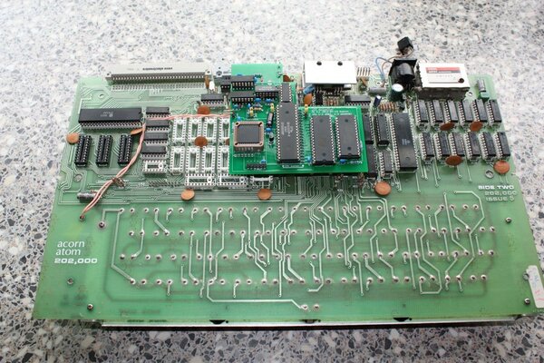

As for bringing the ole girl back to life, it really was a labour of love as so many individual faults had manifested over the years...
Dead 6502
Short Transistor & Dead Caps in the Video Output Circuit.
Corrosion on some of the RAM socket pins causing failure to startup.
4MHz System clock unstable, so I took the liberty of replacing this & the 3.58MHz VDG clock with modern low profile Oscillators, this also helped the Rom-Ram board fit flush.
74LS138 RAM select for the Upper Text RAM was also dead, causing the screen display to be totally wrong in Hi-Res modes.
Mix and match to find compatible SRAM's when used with the boosted clock of the noise killer circuit, if you notice on the finished board, 2 of the Upper Text Rams on the far right are the old type, as the last two modern varients couldn't cope....

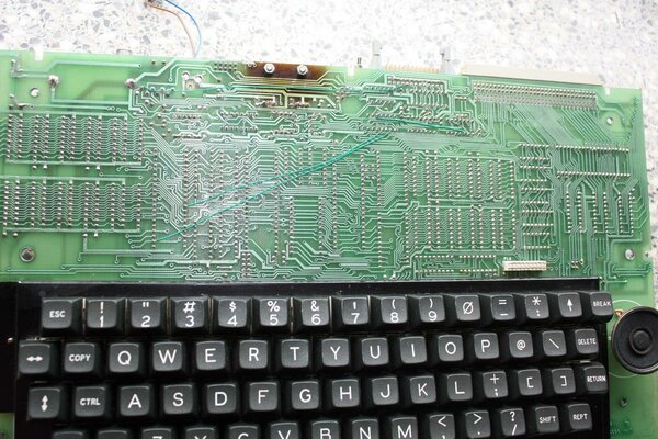

I have fully defluxed the board too, repaired so many joints, the wiring mods on the keyboard side are twofold.... to support the NoiseKiller on the RAM-ROM board & to add 8-bit printer capability..
The Empty sockets on the board, far left are for buffers to support the fitted Eurocard connector on the back, this feature is now redundant thanks to the ROM-RAM board & the MMC.
You would need to fit them to use a std Atom Disk Pack.
The Eurocard socket is of course compatible with Acorn System expansion cards...
The only final part I am waiting for now is the Proper PSU socket to mount on the board & lose the awful trailing wires.
OK, chap's I am out of breath and need a coffee.
I hope you enjoy this article & the pictures, it's certainly one of the most satisfying projects I have undertaken....
