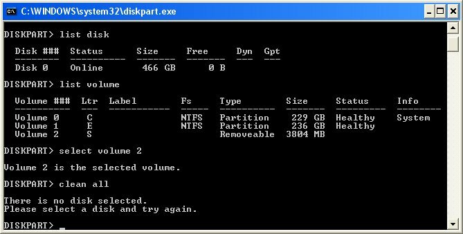

Gouldin, it's only listing Disk 0 - 496Gb (the main HD in my pc) when I use diskpart. It is cos it's usb? 2.5" - 3.5" IDE adapter arrived today, should I try it with that?
Edit:
Ahhh hang on, maybe that other program successfully removed the MDR thing, perhaps that's why it doesn't detect it?
Right, ok I did everything according to your post and as above nothing showed in diskpart and the drive does not show in hdtoolbox after changing to uaescsi.device
I'm going to try using the adaptor now, I'll let you know how it goes.
Only Vista and Win7 versions of diskpart work for removable media like CF cards.
Use Easeus that you already downloaded to remove the MBR under winXP.
Ahh, right ok. I'll give it another going over with Easeus first. Cheers
Hi, thanks but so far everyone had told me to use either diskpart or easeus to remove MBR from the CF disk, and here is what I've encountered:
At no point, so far, has diskpart detected anything other than my 3.5" 500Gb pc HD.
That includes when the CF was unpartitioned/formatted and when it was partitioned and formatted with FAT32. Diskpart and I aren't talking at the moment, it's been a poor introduction to our relationship.
Easeus happily does something called 'delete partition' but there is no mention of deleting MRB, although it does have a function called 'rebuild MDR' which doesn't sound like what I want. It seemed right though because then the drive drops off windows 'my computer'. At least when connected by usb anyway. So I thought at least that would be enough to use it with WinUAE. No.
Whenever this drive is used with WinUAE, either connected by USB or by IDE adaptor, it complains it is non-empty (not true) and isn't an RDB drive upon startup. I ignore this and add it as a uae/read-write hard drive and start WinUAE.
Having changed the hdtoolbox information to uaehf.device, the device still doesnt, and up til this point has yet to, show itself in the device list.
Now I'm sure I'm doing something wrong, but I'm following all the above advice to the letter, including what Goul, Frog and John have suggested. I'm going to go back over everything that's been written in this thread and see if I've missed something.:coffee:
Quick update additional: Diskpart detects the drive as a volume, not a disk. I can select the volume but when I tell it to 'clean' the volume it tells me I haven't selected a disk! Discuss.
attachment.php
Hmmm, sorry, I should have noticed your on xp. I haven't used xp in a long time, but what Frodegh says is true.
Diskpart in windows xp won't work. :(
Not too sure other than following Frodeghs advice for xp.
Sent from my R800i using Tapatalk
No worries, the other program did enough.
