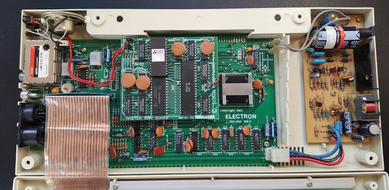

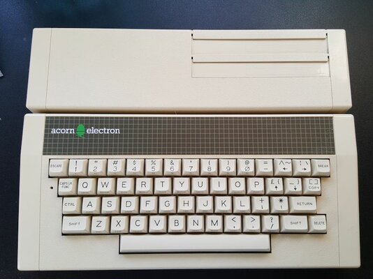

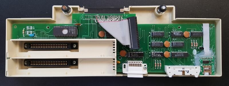

So here's my Elk. Just like Lee Majors it has a certain 80's rugged charm about it. But what super powers lay hidden beneath that creamy exterior?

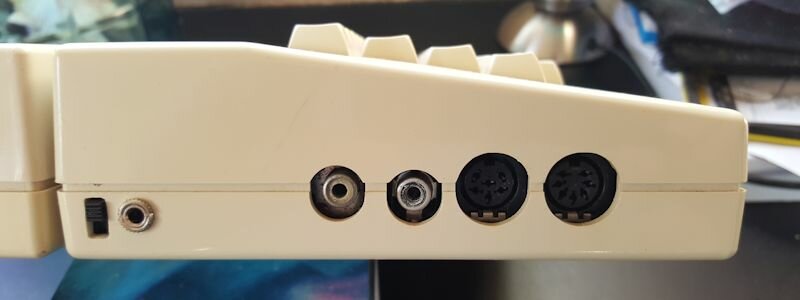

A MicroSD card round the back, a switch and 3.5mm audio socket round the side? If one were to let this Fall Guy I wonder what might be found inside? Always assuming a Six Million Dollar Elk couldn't take a little stunt work.

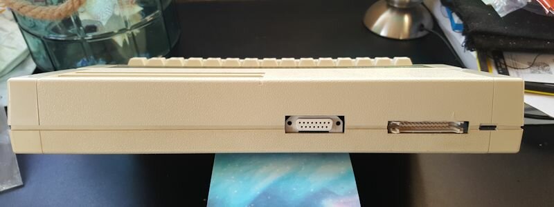

I'm rather pleased with my creation, and the excuse to make some bad puns. My Electron will see a good deal more use in future. The next plan is to fit a couple of Atari type joystick ports mapped to the keyboard but I'm having trouble deciding where to put them. I want my Bionic Elk to keep it's as Acorn intended appearance as much as possible. Ports on the right side would seem best, but what if I ever get a Plus 3? Maybe mount the ports at the front under the keyboard..?

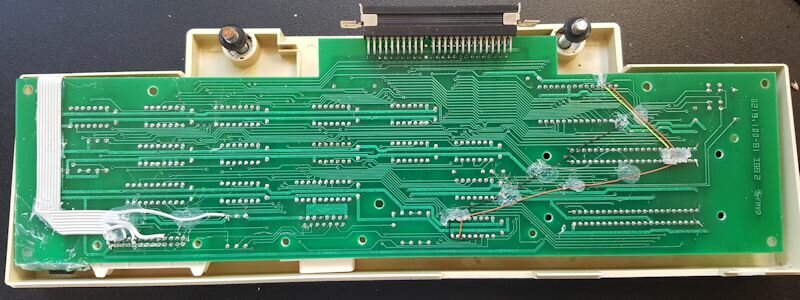

As part of the mod to get some modern mass storage built in I needed to upgrade the 8K ROM capacity for driver software. It can now take two 16K images in a 32K EPROM, but I'd really like to go for four images in a 64K EPROM. I could then have ADT and Jaffa's Mode 7 emulation in addition to the AP2 and MMFS ROMs I'm using. If anyone knows how to cram 64K in to a Plus 1 ROM socket and is willing to share I'd really appreciate it.
