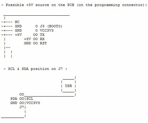

  • I've managed to find a tutorial (more some pics) to connect a 2 line LCD display to the HxC slim, I've seen around that this is now feasible also with the Gotek but could not find information as to how to, anybody has a link, schematics, pics?

Would you know where to find instructions on how to attach a LCD display to a Gotek drive? I've scouted many fora, in many places it says that it can be done, there's also somebody selling a kit here on amibay (which I guess would contain instructions) but I'd rather get the components and find the instructions somewhere else as it would be cheaper.
Thanks
No pics around but found this in the release notes of the HxC firmware for the floppy emulator.
To connect the I2C LCD, you have to connect SDA & SCL at the J7 connector (see below).
Please note that 2 additionnals 4.7Kohms pull up resistors (+5V) are needed on SCL & SDA.
the +5V and GND wire can be connected on the programming connector (see below) :
