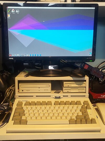

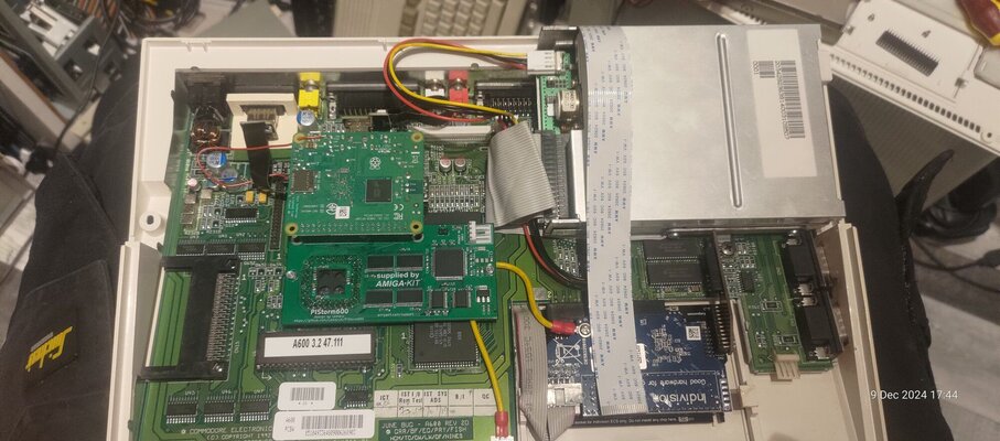

Here is another small project that I have been working on My A600HD PiStorm build
Fitted with the following
Amiga 600 Rev 2 Motherboard.
A600 PiStorm with Pi 3A+ (which gives me HDMI RTG and WIFI capabilities).
Individual Computers A604n
Individual computers Indivision ECS V2
HDMI Passthrough with 3d printed bracket.
Gotek drive as DF0: The addition of Digital Retro Bay's "GoDRIvE600" and Original Teac Floppy drive (09/12/24)
2x Roctec external floppy drives.
Zappo Overdrive CD with floppy inline adapter for the power
ALFA DATA light up tracker ball
A600 monitor stand
CaffeineOS with emu68
The motherboard has been recapped by @scrappysphinx

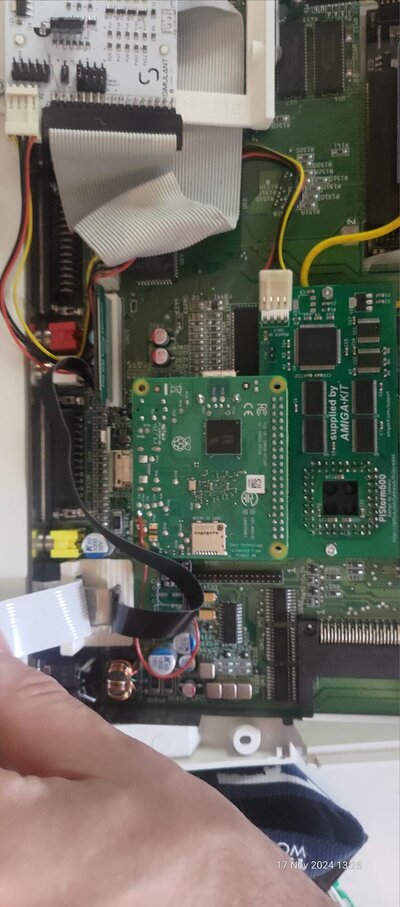

This mobo rev actually give me issues and I would only see 1mb of the 2mb chip ram to fix this I had to downgrade my PiStorm firmware to the original which allowed it to be seen there is not much info on this but it seems to happen with the Individual memory upgrade on the rev 2 mobo's. if i used other memory expansions it was ok but I wanted to be able to use the indivision so needed this expansion to work.
another issue I had was a conflict between the WIFI and the overdrive CD but this was a driver/Assign conflict which has now been sorted.

My PiStorm600 works fine when used with motherboard 2D - anything below shows only EMU68 logo over RPi HDMI output.
I have tried with both Rev. 1.5 and Rev. 1.1 with same outcome.
I’ve been told by reseller there is another firmware for lower motherboard revisions that makes the PiStorm compatible with them.
So my PiStorm works fine with the Rev 2 mobo its was just if I used the A604n memory expansion I would only see 1mb of Chip Ram, all other mem expansions worked correctly showing 2mb. Obviously I needed the a604n due to having an IndivisionECS V2 in this build.
I asked on discord and the member that responded stated I've seen this before, try a different firmware. The only one that worked was the original firmware which allowed the full 2mb chip ram to be seen by the Amiga. the member that had the issue also responded stating it was him that had the issue before and his motherboard was also a rev 2.

@Timtheloon i see you are powering the PiStorm via the floppy connector. Is it necessary? I didn't do it with mine.
I connected it because I will be using the Fan header eventually and wanted to ensure there was no power issues

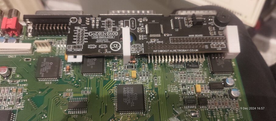

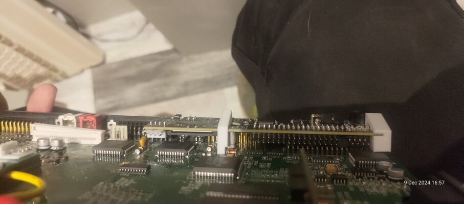

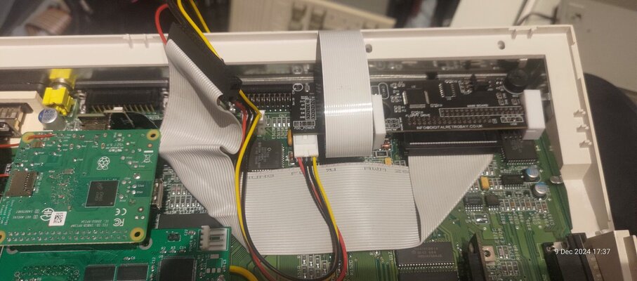

GoDRIvE600 Addition to the A600
A600 had another mod today. The addition of Digital Retro Bay's "GoDRIvE600".
I saw this item at a retro event, and at the time, I wanted to buy it then, but I was short of pocket money 🤣.
This is a gotek device which allows you to hot swap between it and the original internal floppy disk drive 💾.
Now, obviously, this is designed for an Amiga 600 not used with a monitor stand, and I was hoping the control box would fit between the CD-ROM & external Floppy 💾 drives, but it's just a wee bit too big. But using it this way seems to work and I can slide it left and right for now.
I may look into a very long ribbon cable if I find it to be a nuisance where it is and move it elsewhere but it seems to work OK here.
I love the internal design which allows the PCB to fit nicely and safely under the original floppy drive.
You can find them @ digitalretrobay.co.uk and its also available for other models of the Amiga and the Atari ST
The video demonstrates the hot swap and shows the device does not affect external drive functionality.
