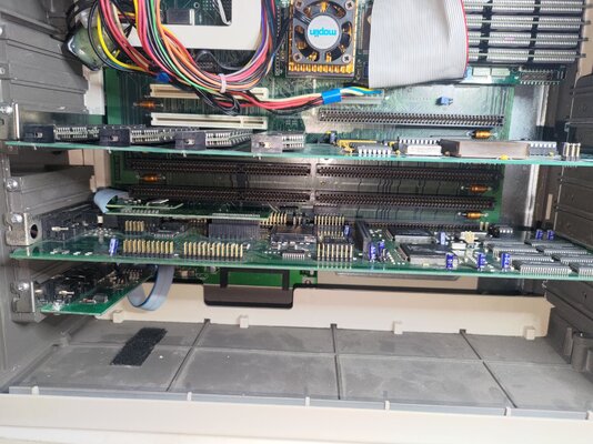

Hello Retro Users

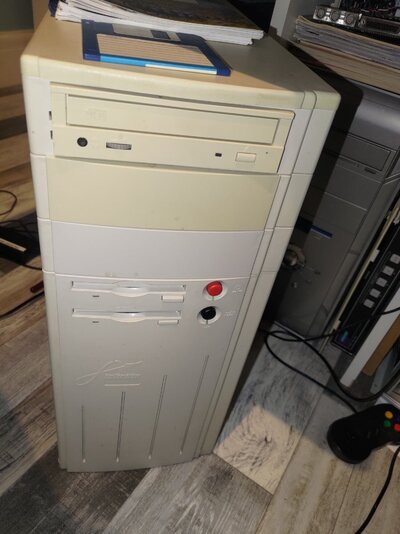

This Micronik Infinitiv Tower Ive had for a while now, but I've never really got around to getting it properly setup

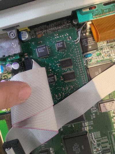

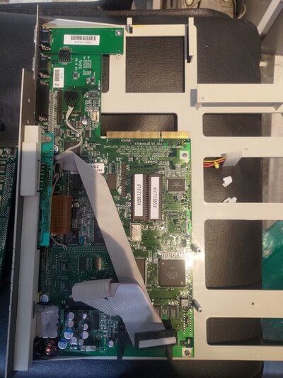

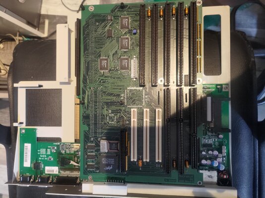

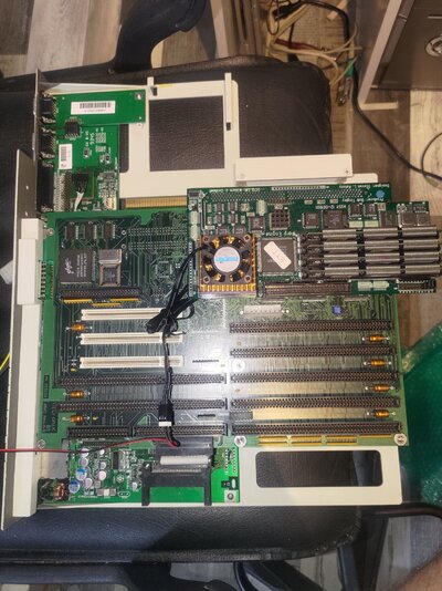

Now this system is fitted with the Micronik 6860 Rev. 6.8 Busboard which is very unique because it allows the installation of an A4000 Accelerator

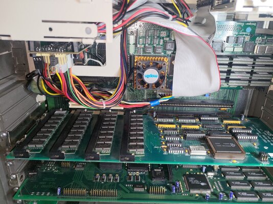

So I installed a Warp Engine 040 40MHz
The installation of an A4K accelerator allow the zorro bus at zorro III spec
Currently I have a Picasso IV fitted and I can also ustilise the PicassoIV's Scandoubler/Flickerfixer due to having the correct Video Slot enabler for this Busboard.
Im usilising an SF2SCSI for the HD at the moment fitted to the Warp Engines SCSI the Busboard its self also has SCSI but the Warp Engine SCSI is faster.
I also have a DKB 3128 fitted with 128mb to bring the fastram memory total to 256mb
Still a few updates to go when I get the parts
I will say these Busboards are fussy and a card in the wrong slot can take the system down.
Give it an AmigaOS 3.2.3 upgrade
The case sadly has alot of yellowing so It will need a retrobright at some point

Very nice, bud, that my my very first Amiga Tower attempt! I was never able to get it going probably as I was using an Apollo 1240, i always heard the work better with A4k accelerators
I always heard the work better with A4k accelerators
It is fussy about A4K Accelerator too like it didn't like alot of them that I tried 😆
If I put a prelude in it the computer wont boot
It also doesn't like the CV64/3D scandoubler no picture seen.
Now this I haven’t seen before or knew you could do. Very nice effort. I’m guessing without the aid of a Buster chip that you would find in a A4000, then this is why it maybe picky on cards etc…
Had one of those plastic fantastic cases once. They were very creaky 😬
I Like & Dislike the case yes its definitely Creaky and wish it was made out of something more durable

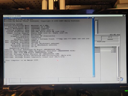

Yeah it must be them 4 x Xilinx ICs that hold the card info I did try a BFG9060 It worked but not perfectly

The Cyberstorm MK 2 works well but I only have 1 working one of them 😆 and it is in my Elbox A4KD Alice build.
I find the Warp Engine to be very stable in this machine. I need a 040 to 060 adapter, which fits this version of the Warp Engine. I'm finding the 040 too slow, for my liking 😆.

Yeah the zorro mode on the busboard is like a ZII+ or something
Its definitely Zorro III it show that on the the system show config I believe the DKB 3128 is a zorro III only card too it just says they are slower that the zorro 3 slots on the A3K and A4K on Amiga Resource.

This is what Show info displays when set to Zorro II
