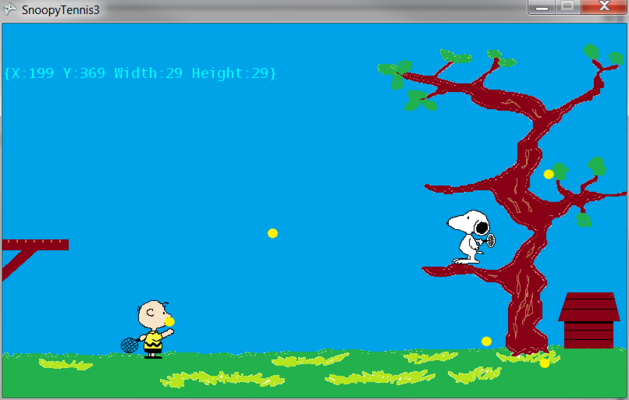

Here's one for you physics and maths wizs.
I'm programming the old Nintendo Game&Watch Snoopy Tennis on XNA. Instead of moving the balls in steps, I've found a formula that gives a natural looking smooth trajectory. The problem however is that I can't get the ball behave correctly, when Snoopy hits it.
These two lines define the initial trajectory, when Charlie passes.
Code:
MovingPosition.Y = (float)(StartPosY + Velocity * Math.Sin(Angle[Trajectory]) * time - Acceleration * time * time / 2);
            MovingPosition.X = (float)(StartPosX + Velocity * Math.Cos(Angle[Trajectory]) * time);
The lines are run for each ball instance's Update method. MovingPosition is the ball's current position. StartPosY and X are the starting positions. Velocity is a double constant of 88. Angle is a single dimension table and it is randomly selected from three first entries in the table, giving three different trajectories. Acceleration is a float set to -9.8 to represent gravity.
So Charlie basically passes all balls nicely to the three points, where Snoopy is supposed to hit them. I already have collision detection implemented, so the hit is detected. Problem is I don't know how to make it bounce from the racket.
If I just simply change the trajectory value or startpos values, the ball seems to teleport somewhere else, when it's been hit. I basically needed to get the ball bounce from the racket and head towards the platform over Charlie, where Lucy might hit it back.
Any ideas?

You've got your ball moving with an x component and a y component, and you want to basically bounce it off the racquet. You're modelling an elastic collision between a point (1d) and a line (2d)
To do this, calculate the normal to the racquet face, then you'll have to sum the vectors of the racquet face and the ball to get the direction that you'll bounce off in...
That might be utterly ridiculous, but it's where I'd start.
You probably want to reset time, and also play with some scaling factor for power.
Another option might be to use the FlatRedBall engine. It's not bad at simplifying this kind of task as it has prebuilt classes and methods for handling collision rebound, and for working with paths and gravity.
And, actually, that might be one way to work around it. These types of games only have a finite number of paths through which an object will travel. So if you can implement a path system, it will solve your problem.
It may be that you are overcomplicating the solution by simplifying it.;)

From a physics point of view, it's more or less what chiark said. Then you can use the dot product of the velocity vector and the normal to the racket to calculate the bounce-off angle (and thus the new x-axis and y-axis projections for the new velocity vector) and initiate a new trajectory using the same formulas (straight steady motion for the x-axis and smoothly accelerating motion for the y-axis) slightly modified for right-to-left movement.
But as already commented, this is overkill considering you won't implement any raquet direction or force or anything physics-like. So all you need is to save the x and y coordinates at the time of collision and use 3 new predefined angles, one for each bouncing point, which you will calibrate until you get the desired bounce-trajectory for each bounce-point. Thus you reuse your original trajectory equations:
time must be reset to 0
StartPosX = the saved x coordinate
StartPosY = the saved y coordinate
+ becomes a - in the MovingPosition.X function for right-to-left movement (implement a sign-change variable in the function itself).
This way the game will work in its intended predefined-path way and the only use of these physics equations is to provide for smooth ball movement.
Thanks! That did the trick. :thumbsup:
I had to remove the time multiplier in MovingPosition.X function to prevent the rebound balls from actually picking up speed.
It's really nice to see the balls behave the way I want them to after such a long time. Next thing is to determine suitable rebound trajectories based on Snoopy's position.

Since you all have been so helpful in solving the trajectory issue, I thought it would be only fair to share a WIP picture of the game. Enjoy!
