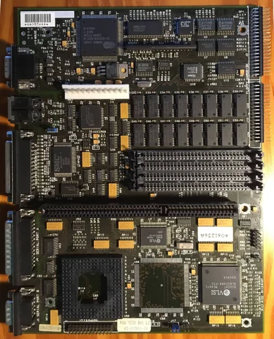

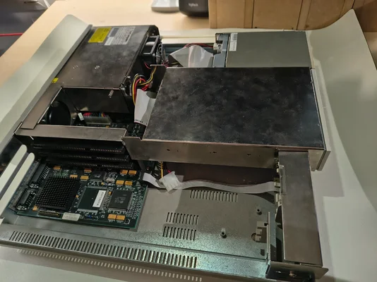

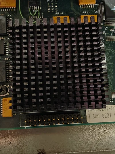

Hi champs! I have this Tulip machine in very nice shape, I can't however figure out if the CPU is soldered or just socketed very firmly. I was hoping someone is able to shed some light on it.
It's a Tulip Vision Line DT486dx50i with a 486DX2 50. There is no visible latch and I can just barely see that the heatsink is clipped onto a ceramic cpu top.
I added some shots of the machine in question. If you need more detailed shots, please let me know.
I have not removed the motherboard yet, I am kinda afraid I will break stuff or fail to put it back together properly.
Edit: Last picture I found online, this is the motherboard in question, it looks like a proper socket, but I don't recognize it as a regular socket 3.

It might be a pqfp196 instead, I couldn't get it unseated. Didn't remove the motherboard altogether, these units are pretty tough to put back together.
A soldered PQFP CPU would have been placed on position U56, which is left open on your board.
Also if you see a ceramic CPU top then it can't be a PQFP (P = Plastic).
I am confident that the CPU is actually in a socket.
