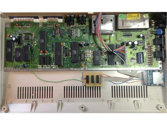

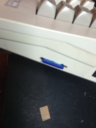

Yet another uIEC mod, but this time I wanted the "next" and "previous" disk feature of the uIEC, but without extra buttons in the case..
I also want JiffyDOS, also switchless, that part is easy as this guy already did the work: http://pasilassila.blogspot.fi/2014/06/switchless-jiffydos-for-c64-short-board.html

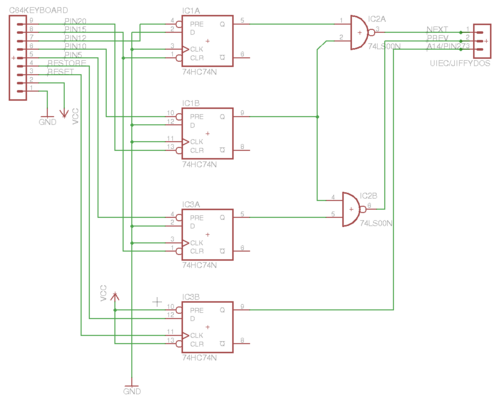

So what keys to use, to be sure it won`t interfere with jiffydos or whatever else.
I decided "CTRL +" for next and "CTRL -" for prev. JiffyDos will use the normal RESTORE on boot for disabling.
So heres the pics, and so far it works great. Any hints on improvements will be appreciated.
