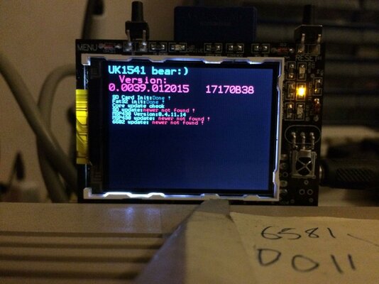

I received my UK1541 today, promptly unpacked it and tested it with the two SD cards I use with my 1541U and 1541U2. Unfortunately I don't get very far, presumably because the beta firmware is incompatible with my SD cards (one 512 MB, one 2 GB).
Usually I get a little status text when it power on:

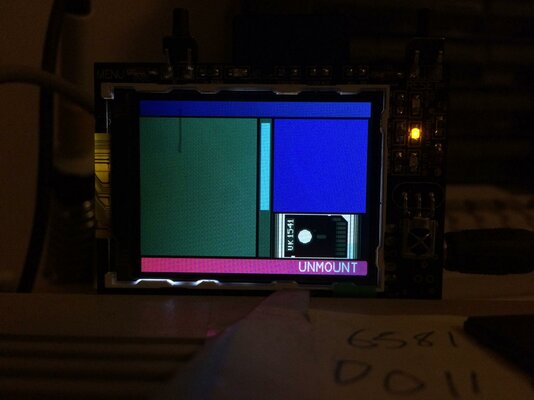

Then after a reset an empty dir listing:

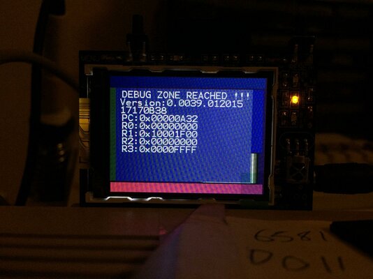

Only reset works, pressing fire results in a crash:

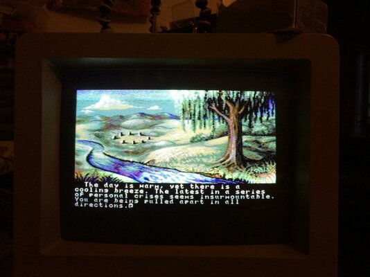

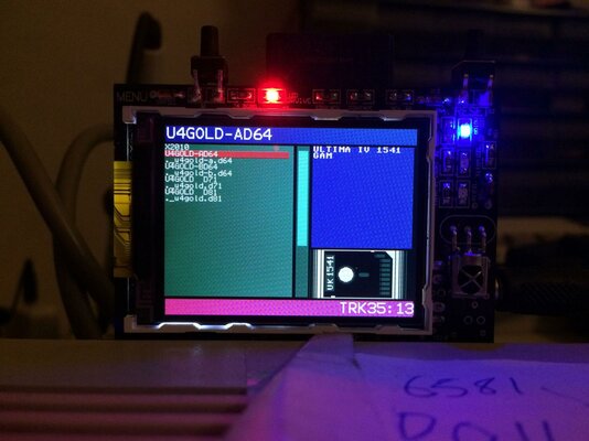

Success with a 4 GB SDHC card I picked up today!
It happily loads and runs Ultima IV (using my uload m4 irq loader):
It sometimes gets stuck on this screen though, and I have to reset or power cycle a few times to get past it:

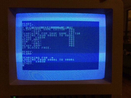

After playing for a while the loader hung. Resetting the drive emulation left it in a state where it tries to load files but fails with load error. I can (slowly) get a dir listing, but not load anything:
Unmounting and mounting the d64 again fixes it.
Yes, this is what I call misaligin after core reset, needs to be done properly. Unmounting and mounting is a temporary solution.

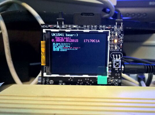

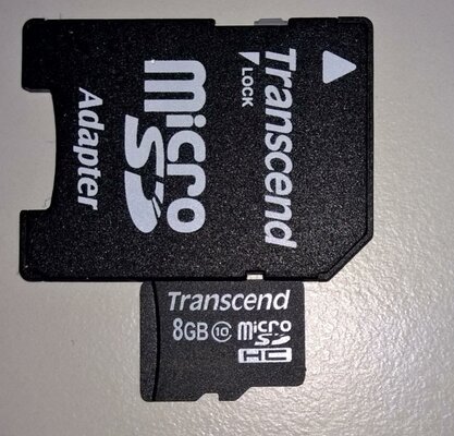

New 8Gb Transcend class 10 microsd card, formatted with windows 8.1 with settings like the wiki suggests.
And inserted to UK1541

Newcomer Enhanced - UK1541 goes into DEBUG screen right after you load the boot program.
