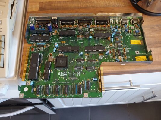

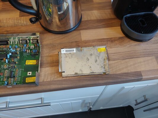

Hi Guys still playing with the system but yeah menus in English and the 501 now has no battery only a little leak all cleaned an Lemoned away yay plus still works a treat
