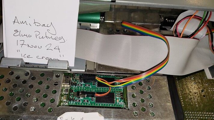

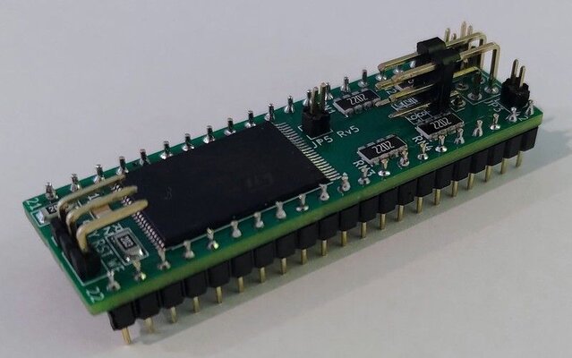

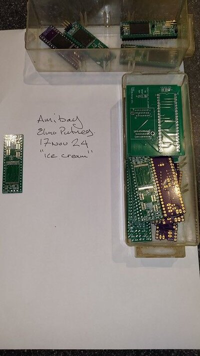

Hello,
Twin kickstart machines have have half the code in each chip, so I was looking for a switcher that could use this "advantage" to fit more roms in or use lower cost storage. I could not find one so I created one and in the process I have spare boards and parts lying around.
*******Buyer must prove ownership of Kickstart ROMs to be flashed via PM*******
-42 pin
-A500 rev5 jumper
-Optional pull-up resistors (rev5 requirement)
-Low profile
-Use jumpers or route to a switch
-29F800 1Meg flash= 4 x standard kickstart or 2 x custom big kickstarts on twin kickstart machines, half that on single kickstart machines.
or
-29F160 2Meg flash= 8 x standard kickstart or 4 x custom big kickstarts on twin kickstart machines, 4 and 2 on single kickstart machines.
*I believe A1200 & A600 can use "big" (1Meg) kickstarts out of the box, but you need mods on everything else, (not sure about A500+ / Rev8??)
I can leave off Pin 1 and Pin 42 if you want to use this in 40 pin sockets
I have a bunch of boards and parts that I need to get rid of, this is not a money making venture! Parts will be built to order as per your requirements, sometimes I will be on holiday and things!
Cost is around (depending on options) £35 for a PAIR of 1Meg, or £45 for a PAIR of 2Meg
