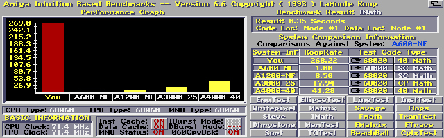

- New 68060 code emulates "Unimplemented" instructions
which caused AIBB to crash on 68060 systems (unless the
CPU tooltype was set to 68000/010).
- Runs all original AIBB code on 60000-68040 systems
- 100% PC relative Assembler code
- Patched executable is only 212 bytes larger than original

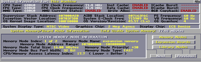

- Replaces 68040 output strings with 68060 strings when a
68060 CPU is detected. Supports LC/EC variant and Copyback
strings.
- Fixes a typo bug on 68LC040/68EC040 user requester
(68EC060 string is now corrected to 68EC040)
- Updates version to 6.6
