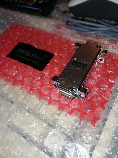

I have a few different usb mouse adapters, but I am having trouble with one of them!
It is this one:

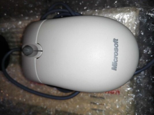

I have a pair of usb mice that work with every single usb adapter I have! they are basic Microsoft laser mice nothing special about them.
But they refuse to work with the Amigakit adapter.
All I get is a brief flash of light from the mouse and then nothing :( I have tried it on two A1200's and both the same thing happens.
I also have another usb adapter clone, that appears visually identicle to the Amigakit one and both mice work fine with it! even the scroll wheel works.
I bought the clone from ebay years ago and it just works perfectly no fuss at all.
Has anyone ever run into problems with these adapters? both amiga 1200's I have setup were re-capped and they work 100%.

I have one of these and it works fine on an A2000 and A4000, don't have an A1200 to test on. Any chance you can try your adaptor on an A2000 or A400, just wondering if the issue is with the A1200.
