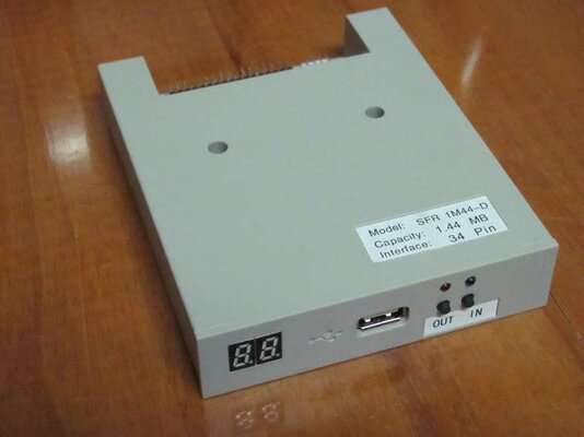

I'd like to install a USB port on my A1200 (original case) and found the Subway. But should I make it my sub of the day? Because this morning I've found something I've not seen before - USB replacement for 3.5" floppy drive.
On a different website (not "that" website, although it is there also) this was said: "Not only will this device work in PCs but, it will also work in machinery or devices that still use floppy drives".
Could be a neat way to solve the USB needs. Has anyone tried it? Shall I try it and report back?

if you can hack the floppy to be ami compatable then I see no reason why not to do it.

Plus, i'm pretty sure the guys selling them will not actually guarantee that it works with an Amiga.
That's a risk, for certain. I'm reassured by their "any machine with a floppy comment" and the thought that this device doesn't use either the Amiga or PC floppy file system but simply hacks the floppy port for use with flash memory. So if it doesn't work, it will make a doorstop (albeit not as expensive a doorstop as you first thought) or I'll whack it into my wintel (wamd) instead.
Another thought, perhaps this device, if it works, could be squeezed into an external disk drive case and plugged in that way.

However, here is the picture of what I'm getting and I'll post some better pics when it arrives.
attachment.php

If you search a bit more you can find also the 720kb DD emulators with up to 100 DD floppys per USB stick.

OK, let's assume that you have to 'freestyle' this to get it working with an Amiga.
It will need the 'Disk Ready' signal enabling and that involves joining pins 1 and 34 of the connector together - this can be done via the floppy cable. It will need this to be a bootable drive. As to if it will boot and 'see' disk images, I really don't know.... if you are using images, then the 720k / 1.44Mb debate is sort of irrelevant, as the drive will cope with both. The true issue is if this will emulate a floppy that the Amiga can work with.
You may also need to check if the drive is selectable as DS0/DS1, as the Amiga wants drives that are set as DS0. PC drives are normally set as DS1 and the twist in floppy cables sorts this out in PCs, as they normally all leave the factory set as DS1 and the cable determines which is DS0 (A: drive) and DS1 (B: drive)
I think if you get a two-connector floppy cable with the twist in it between A: and B: drives, then connect pins 1 and 34 together, you may find that the Amiga 'sees' the drive on one of the connectors and displays DF0: or DF1: at the Workbench screen.

I agree with you, as disk writing support could also be an issue; the HxC USB version doesn't have write support, however the SD Card version does, and I think that this drive might also fall over when asked to write data back.
There's nothing I like better than desecrating cables - pass the soldering iron!. No diode needed? I saw something on Aminet about a diode...

You shouldn't need a diode in the wire between pins 1 and 34. Most 1.44 PC floppy mods to make them Amiga compatible use this link wire without a diode. A simple link wire between the two should do it.
Pin 1 (Ground) just ties Pin 34 (Disk Change / Ready) low, so that any disk inserted is intialised by the drive.

Not pin #1!!!!!!!!!!!!
You must swap pins 2 x 34, on floppy units ALL ODD PINS ARE GROUND. Also the unit might not have the ready signal, so you can do a little hack: join pins 30 & the "new" 34 so when the data signal transmit it will fool the ready signal the Amiga is expecting.
Also remember the unit must be set to DS0 instead of DS1 from pc-world.
