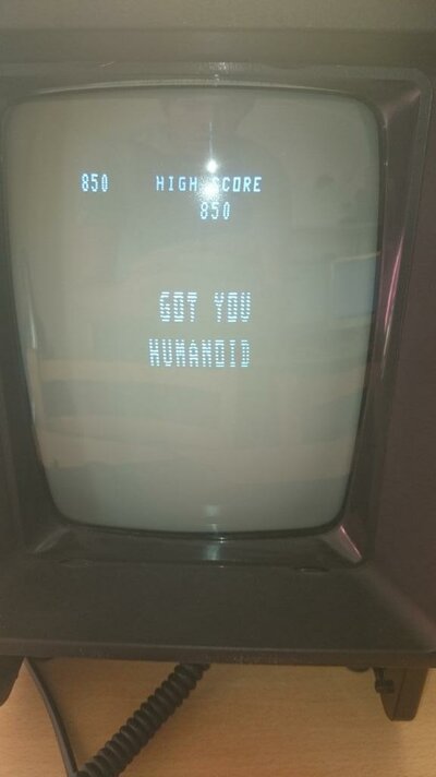

Hey there everyone, really hoping someone can help, here's the facts
I own 2 Vectrex machines, one of which has always had the dreaded white dot and one of which has always been fine . . . . untill recently
a few months ago when i last used the 2nd (working) machine all the graphics were bunched in the top right corner but after 2-3 minutes they moved into place and everything worked fine, this happened whenever i wanted to use it and i had no real issue with it as it was only a few minutes . . . however today when i go to switch it on the graphics were more bunched than ever and it took more than 20mins for them to settle into the right position and even then they weren't quite right (very wobbly, occasionally shifting and resizing etc) clearly the problem has gotten much worse
Looking around the interwebs it seemed the most simple possible fixes were to brush the dirt off the boards with a paint brush (the 1st system had very dirty boards, the 2nd much cleaner), reseat the socketed chips and clean the cables which connect the 2 boards, i've tried this on both units but got no change out of the systems.
I'm no genius with these things but looking around i couldn't see any signs of cap leakage or damage to the trace on the boards so now have no ideas what to do/try next?
any help would be greatly appreciated

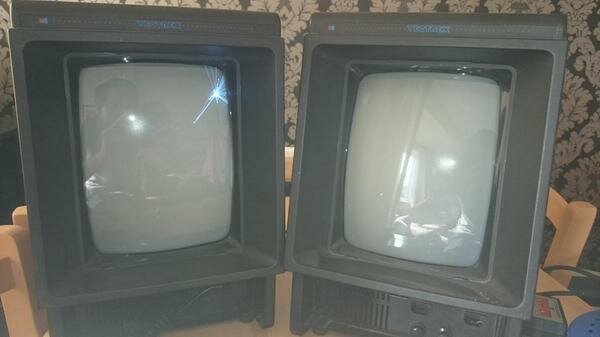

alternately anyone in the local area (Leeds) who thinks they can fix the units would be welcome to one if they got one of them fully working for me to keep but due to the size, weight and fragility i'm not going to post these guys, i've included some photos to explain better
Above: both units, one on the left is the one described as "2nd" with squashed image, right is white dot system

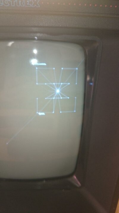

Above: shows the one with squashed graphics struggling as it warms up
Above: after being on for quite some time she's just about showing the image but its not stable
i can provide video if needed too so you can see the shifting/resizing of the screen
Thanks in advance for any help people can offer, even if it's just what i should be looking at or what i should do next
