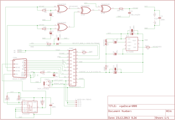

Self made Vga to Scart RGB adapters for TV-frequency VGA-signal (vga card needs to ouput 15625Hz/50(25i)Hz.
At least 4 pcs of version "008", first in this series. (slightly different "009" pcb ordered)
20€ /pce
optional 24c02 or 24c01 eeprom 1€
optional 3.5mm stereo plug cable for sound 1€
shipping 3€ untracked
Male hd-15 vga (can use female-male cable to video output if +5v connected)
Can be connected directly to vga output, but it puts heavy weight on the connector on mainboard or video card.
Scart socket (v008 cuts them a little to fit on pcb). 3.5mm stereo phono jack for connecting cable to sound card/mainboard phono jack.
Linux can take advantage of EDID eeprom for 15kHz television signal while booting, except grub/boot loader screen (Windows probably doesn't understand television modes directly.)
Has voltage doubler to select 4:3, and the other signal is driven to select the scart rgb input on television.
Doesn't have protection to shutdown bad frequencies to television.
74HCT86D circuit makes scart synch pulses regardless of vga sync polarities, as Tomi Engdahl circuit on ePanorama.net
There is no information page on www for this board, at least not yet.
This adapter follows many other vga to scart adapter circuits found on the web, but adds an EDID eeprom socket and voltage doubler in order to make one of the input selection signals on scart interface.
Schematic should show many details.
