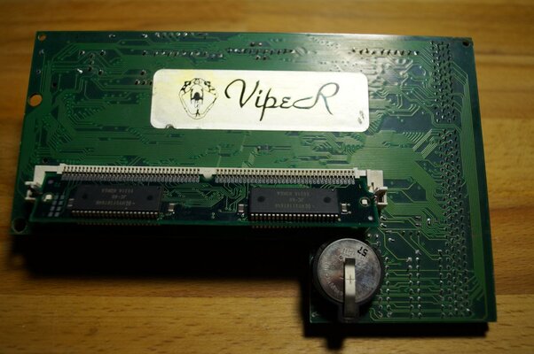

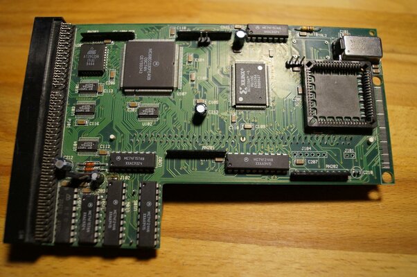

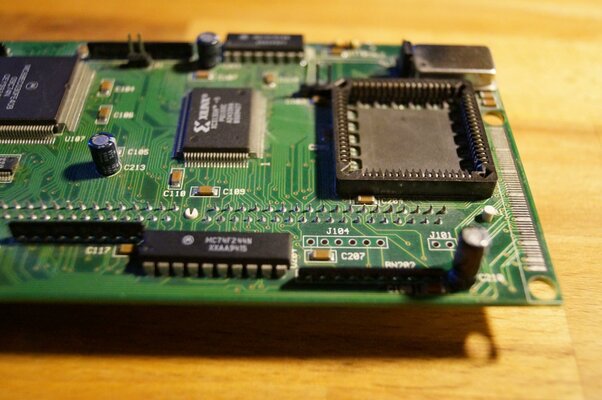

I got for free this 1230 Viper accelerator for my 1200. If you notice in the cpu it has 2 bend pins. Although they are not touching each other and the card was working fine for many years with the bend pins. It was stored in a cabinet for some time and now it is not booting (black screen). Now, I tried different ram memory simms but I had no luck. One thing that I notice, if you look the third photograph in J102 there seems to be some kind of leaking. So is that possibly a leakage from the capacitor near by? Also I searched but not found a clear photograph for this card, because I am not sure if there a smd capacitor missing from J102. Maybe someone has any information about this one?

The brown substance in the third picture is more likely soldering flux - that jumper has probably been closed by someone with a soldering iron and not cleaned afterwards. It's not dangerous to the card.

Hi,
This card has optional socket for PLCC FPU and has on PCB two Quarz position + jumper. You have 100% 40 mhz quarz in right position and too jumper ok settings? What test with another quarz - is socketed?
Regards, Sveta

This is the only photograph that I found in the net. I just noticed that the viper in the photograph has a capacitor in the right-down corner (C210). Mine has only to pins there, and as far as I know, there shouldn't be any pins there if a capacitor was never installed there. Maybe this is the fault?
You've ripped C210 completely off the board somehow. Those "pins" are the internal contacts of a capacitor. Replace the capacitor and it should work fine again.

I installed a new capacitor today 25v 33mf, I even cleaned the pins in the socket of the card but still gives me a black screen. I am not quite sure about the position of the jumpers, but I have them like in the photo of magnum above. So I tried 2mb, 4mb and even 8mb simms with no luck.
Do you have any test equipment to check that it's powering up and getting a valid clock signal?
Bryce.
A multimeter won't be enough for proper debugging. A schematic isn't really necessary for the basics: Checking clock, address and data activity.
