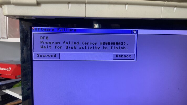

i have a towered A1200 with BlizzardPPC SCSI and mediator, i finally decided to installa AmigaOS 4.1FE that i bought some years ago.
as i have a SCSI had drive i had to find an IDE solution and i decided to use a SD to IDE adapter using industrial SD as hard drive, this way i can have several worbench installation to use in case of need. I bought an AS adapter and tested it with AmigaOS 3,2 and it boots without any kind of problem.
So i installed AmigaOS 4.1. FE on a 16GB SD card smoothly.
But when i powered the Amiga up again i get a 8000003 error message claiming that it's the drive DF0: causing problems.
I tried with 3 different drives (original amiga, adapted PC and Gotten) but the result was the same.
If i unplug the drive the Amiga boots up nicely, so it's looks like there is some kind of problem between the SD adapter, the disk drive and AmigaOS 4.1 FE.
Ah last thing, if i boot AmigaOS 4.1FE from CD there is no problem at all, i get no error message, so it really looks like that there is a problem with the SD adapter!
Is there anyone that had the same problem? Is there a solution?

As for the one you are currently using, it seems like it's making the Amiga think there is 2 DF0: drives on the system bus and it simply doesn't know which one is correct. As per your experiment, removing it does look to indeed be the solution.

Well the result is that CD rom doesn't work anymore, i tested with my 2 different IDE adapters.
Moreover i have the same behavior with DF0: errore message, so it's not the solution.
I tried to replace 3.2 rom with 3.1 and it works!
So it looks like it's somethings wrong with 3.2 rom.
Now i am performing a complete AmigaOS 4.1FE installation let's see of it works

AmigaOS 4.1FE works ok now with 3.1 roms.
Roms 3.2 gave that DF0: error message on 4.1 booting up but i was able to manage installation.
Does anyone know if 3.2.2 roms fixed this kind of issues?
