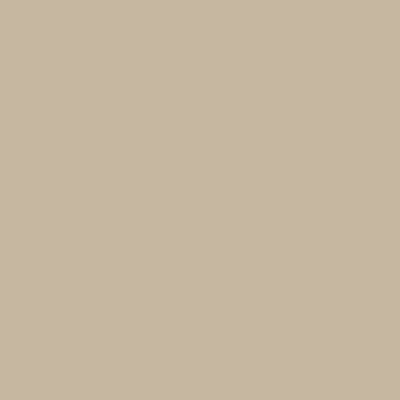

That really does look nice I use a spectrometer for photography and is able to create pantones when I have time I will give my 500 pride and joy a scan and see what it comes up with.
edit: Captured :)
