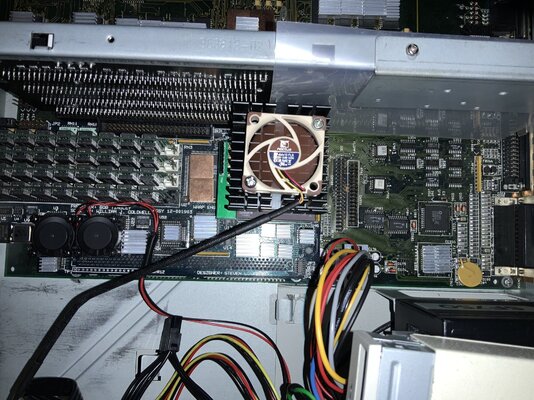

@saft6luck. May have found a compatibility issue with Rev 2.2.
Just to let you know, I have just struggled to get a Warp Engine 040/060 to this board. Every power on I just get a dark grey screen on power up. On putting the board back into an original Rev B board. All is well.
Not sure if this is to do with the Kickstart ROMS (3.2.2 47.111). Even though the same ROMs are being used on my original Rev B commodore board. Or maybe it’s something else?
What I have tried to diagnose:
Nothing on the main board. Just left with the onboard 2MB chip. Just power and the Warp Engine. No issues if I 0lug in a Phase 5 Cyberstorm 060/PPC as this starts up no issues.
Just putting it out there 👍🏻
The board was tested with the late version of the warp engine 4040 and did work. If I can borrow your board I might be able to trace down the problem.
Hi,
Thanks for the prompt reply. I can confirm that the Warp Engine I have definitely works fine when plugged into a Commodore Rev B board.
When I picked up this card off another sales site. I had no clue to the revision. When I put a wanted thread up for a 060 upgrade for it, a few stated it was a rev 2. But looking on the big book of Amiga Hardware, it maybe a rev 1.
I have attached a pic of mine with a few heatsinks on to give you an idea.
Here is a link I used to try and reference my card revision
Unfortunately I am of need of my card to get a stable working system, so will be unable to send this to you. I can confirm that the rev 2.2 will fire up with a rev 2 Phase 5 Cyberstorm 060/PPC card.
Thanks again.

Looks like rev 2.4 is now available? Sorry my German is poor. From what I can deduce the building of this revision is now underway. SCSI now appears to be one of the new features built onto this revision.
Who is building the new Rev 2.4?
Yes, V2.4 is under test now. There will only be minor changes, like a connector for the reset signal used by the KickSmash board.
Except for testers, there are no builds available right now.
Other topic: are you able to burn the 16v8 GALs? I‘d like to try a change of U701 to address the problem of your WarpEngine.
@saft6luck Thanks for the reply. Look forward to seeing the outcome of the rev 2.4 tests.
I don’t have the tech or know how to burn GALS at the moment. Sorry.
