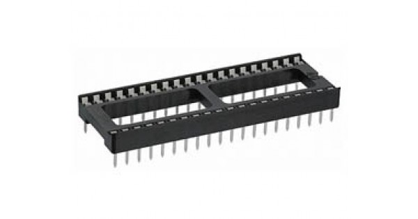

Where to get 64 pin DIP sockets to 68000 CPUs?
  • Thread starter Thread starter utri007
  • Replies Replies 10
  • Views Views 181
The socket in your link appears to be a narrow-row part and hence not suitable for a 68000 CPU in DIP package.
According to the socket's datasheet it has a pin pitch of 1.778mm while the 68K uses 2.54mm
0.97€ 😎
Instead of buying a socket, it's more cheaper to place 2 single rows, 32 pin each with round holes. Aliexpress is the place.
0.97€ 😎
This has square holes, not round ones. Something like this would be OK https://www.stathisnet.gr/vasi-ic-pcb-dip-40pin-15-24mm-2-54mm-epixrysi-connfly this one has 40 pins
I would think the only difference being aesthetics
A proper socket installed on the motherboard looks nicer :)
