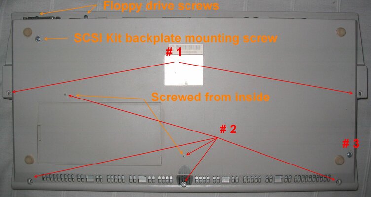

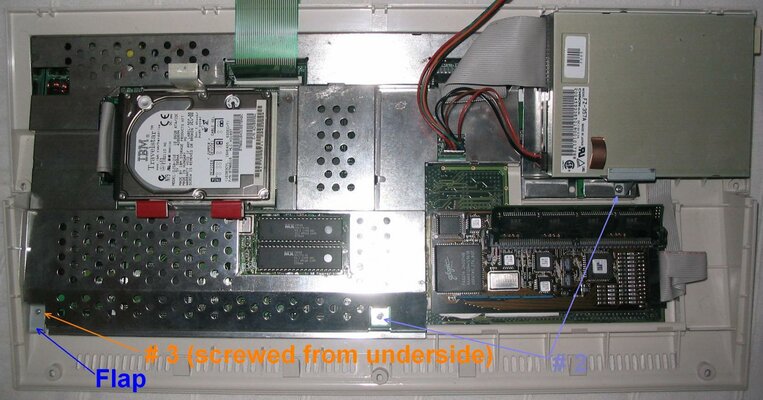

Here are a few pics.
These are based on this specific rev2B A1200, which I got with the warranty seal intact so I would assume this is the factory default configuration.
Type #1 can be replaced with #2 however without problems (I would suspect it's still better to use the longer #1 type as the screw-hole is probably longer for a purpose).
Note the flap used for screw #3.

Aaaah I don't have the flap so I guess that is why I cannot get screw #3 to tighten.
Nice screw guide BLTCON0, that's exactly as it should be, the ones for the LED are usually slightly shorter again :)

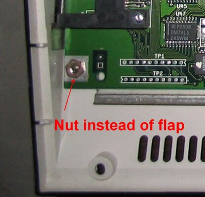

If you don't have the flap, you can just use a suitably sized nut (see photo).
Actually it is the the bottom left screw which I cannot get to tighten (not the one which goes through the motherboard). I just keeps turning :( - most probably the hole grooves are worn out. Is there a way to fix this?
Yes, this newer photo I posted is of the bottom-left screw.
It's just from another A1200 I have, for which I also didn't have the flap.
There are no threads for that screw on the case - the threads are provided by the flap.
I mean the bottom left screw of the case, not the motherboard one. The one under the text reading "Nut instead of flap".
Well, then maybe the thread is indeed worn out.
Easiest workaround would be inserting a thin plastic strip along with the screw, to make the hole narrower so the screw gets a better squeeze.
Do not use a thicker screw!
If you want a permanent fix, you can fill the hole with some hardening substance (araldit superglue for example, or even better find someone who works with plastics) and then carefully drill a new hole with the thinnest drill bit (thinner than the screw), then drive the screw back into place so it will carve new threads of the appropriate pitch.
