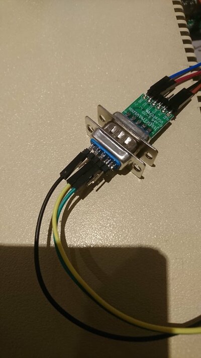

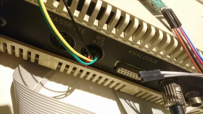

Next step is to hook this up to the BBC/Master. If you're just going for standard RS232, just use the TxD, RxD, GND, CTS and RTS pins - you might need to use DSR/DTR instead of CTS/RTS depending on your machine, be prepared to try different combinations. Anyway:
On the domino plug, looking at the solder side, join pins 5/2 (RTS/CTS, red link in my picture), and take lines from GND (centre pin 1), RD (4, Green in my picture) and TD (3, Yellow in my picture):
Take TD to the TxD pin on your level shifter and RD to the RxD pin (That's pins 3 and 2 respectively of a 9 pin connector on mine), and GND to GND:
On the other side, the MAX3232 will need 3.3V from somewhere (you could snaffle it from the LoLin board) and you can bring the GND from it out to attach to the LoLin board...
Connect the TxD output to the TX pin on the LoLin board (black wire on my picture below), and the RxD output to the RX pin of the LoLin board (brown wire), GND to G (blue wire), and then it's up to you to choose how to power the LoLin board - I've taken 3.3V from my beebscsi (red wire again, but a different red wire to the previous picture) - but you can take 5V and feed that to the VIN pin, or you can just use a USB adapter and power it through that. Entirely up to you. JUST DON'T FEED 5V TO ONE OF THE PINS MARKED 3V! YOU WILL FRY YOUR BOARD!
