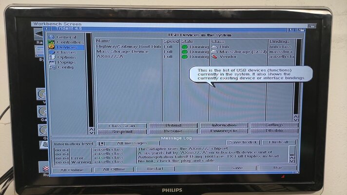

Hi,
I've tried it just today - TF536 + Clockport is working perfectly. And that's correct - INT6 Signal is needed..
Here You can see USB Stick and LAN Dongle are connected and working well
