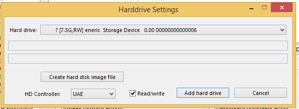

Hi everyone,
I have another problem with WINUAE trying to setup a CF card. When I try to add a 8GB card I get the following screen shot.

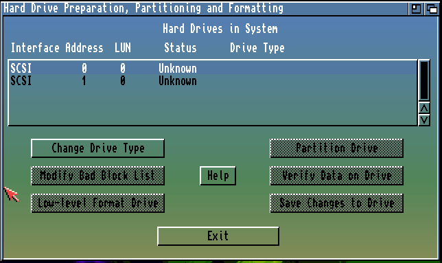

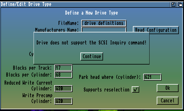

When I go into the ClassicWB I setup it shows the following when trying to setup the disk with HDTools

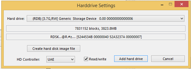

With a 4gb CF I prepare about 12 months ago I get this when adding the CF card
What am I doing wrong?

When adding the Hard Drive, WinUAE don't recognize well the CF (as you say)
HDInstTools (UAE or IDEX)
- Empty&Clean or used CF detected as two or three SCSI devices with different IDX
- Can't write in "Zero Sector"
- Can't write (use) drive "unit type 25" (or something like that, I don't remember)

Perfect!! that did it. I suspect it is something to do with how windows clean command works on WIN8 as opposed to WIN7.
Thanks so much for that one.
