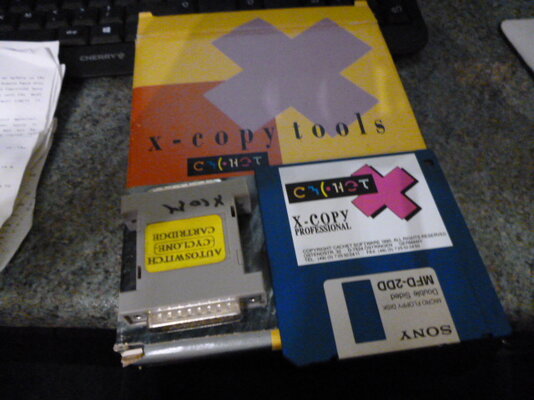

Does anyone have a cheap X-Copy dongle (or clone) they want to sell?
I am in the US, although it shouldn't cost a ton to ship one here.
Most such dongles are passive devices which rewire 3 lines to "decouple" shared signals and rely on dedicated software (X-Copy) to control them properly.
You could craft yourself one by using two DB25 connectors trimmed down to 23 pins (it's not very hard).
If you have a generic external floppy with a typical 24-pin IDC header (23 used) you can perform the rewiring directly on the header of its adapter board (if you don't mind permanently fixing it for clone use) or maybe add some switches to toggle between straight-through and clone mode.

As seen, pins 16 and 17 (DKWE and DKWD respectively) are decoupled, so that DKWE can be independently controlled for the external drive by using the (now useless) SEL2 signal on the Amiga, and DKWD for the external drive mirrors in real time the (also decoupled) DKRD for the internal drive. This is more or less the clone mode trick - the raw bitstream as read on internal DKRD is mirrored in real-time on the external DKWD.
Finally the INDEX input of the external floppy (pin22) is wired to input signal CHNG (pin11 on the floppy connector) so the software can independently track revolutions of the external floppy.
Of course all this relies on the specific X-Copy software and obviously disallows any other external drives.
X Copy.JPGIs this what you are after?
Look there, it's very easy to make a copy using the right connector and wires, no PCB needed
"https://www.bigbookofamigahardware.com/bboah/product.aspx?id=1534"
This thread can be closed. I did end up making my own out of an old DB25 gender changer. I sawed off the end of the female side with a dremel, rerouted the lines, and pulled the pins and shield on the other side. It works.
