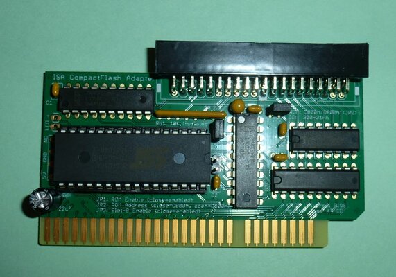

It is an 8-bit ISA-bus plug-in card, which allows the operation of "normal" 16-bit IDE flash modules, such as DOMs and CompactFlash cards in an appropriate adapter. Up to two "drives" can be connected as master and slave.
The detection of the connected storage modules is done fully automatically during booting (there is no BIOS that could be configured).
This special "XTIDE CompactFlash" version does not support real HDDs. (at least I wasn't lucky to do so).
The target system are old ISA-PC / XTs, but the controller can also be used in AT systems.

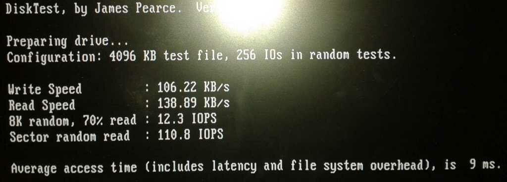

Who wants to see it in action (german):
https://www.youtube.com/watch?v=CdsUfJHtgN0 - Yesterchips

- Base-equipped XTIDE controller
- Flashed for PC / XT operation (also runs on AT, see below)
- Basic memory address C800 (can be changed to D800)

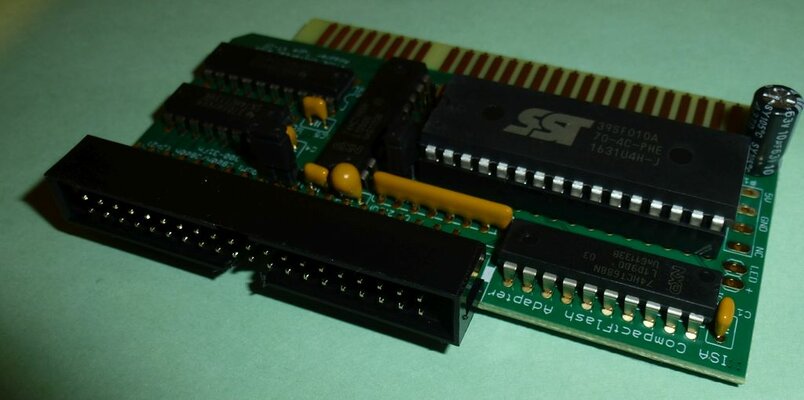

- Vertical-mounted IDE-Socket, full-featured 3.5" IDE connector (40-pin)
-> This allows you to connect very space-saving DOMs
-> For this I had to modify the IDE-Socket (see photo)
- Each board is tested for bootability using a reference system (Commodore PC-10 3 (XT))
