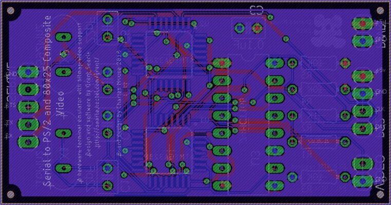

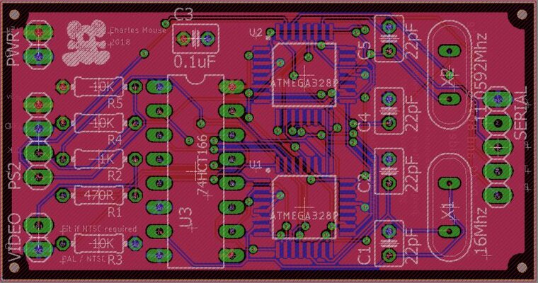

IO Board:
-PS/2 keyboard connection
-PAL or NTSC composite out (B/W)
-ANSI subset to allow support for serial terminal commands
-Much expanded instruction set to allow for full screen scrolling and graphics
-Fast as it does all it's own processing and doesn't eat any system memory

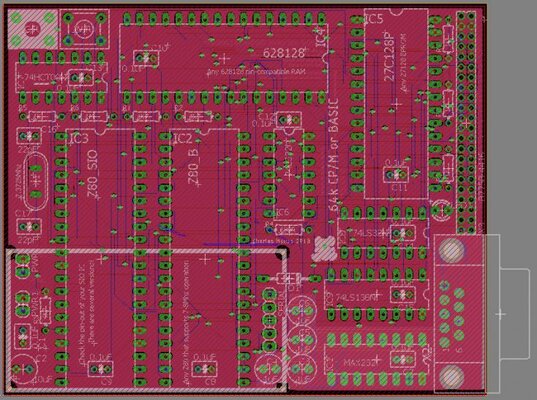

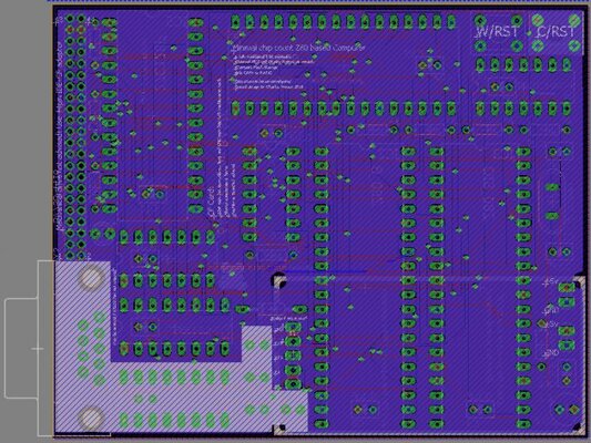

CP/M Computer:
-Nine IC's for a full 64k CP/M and BASIC Z80 computer!
-Two independent serial ports
-Support for CF storage up to 128mb as storage in multiple partitions
-File transfer facilitated by serial terminal and transfer software
Together:
-Both boards will result in a very small and quite fast stand-alone computer with either PAL or NTSC composite out and a keyboard connector

The board designs are mine but I'm not knowledgeable enough to come up with my own CP/M computer and then write all the support software to make it work. This is heavily based on Grant Searle's excellent work and really all credit should go to him. I just adapted his design in to practicable schematics that could then be used as a basis for PCB layout and manufacture.
