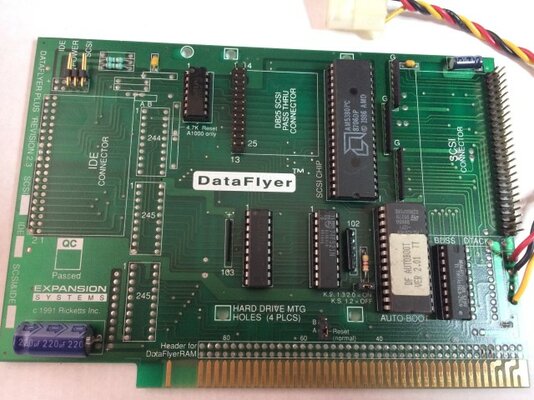

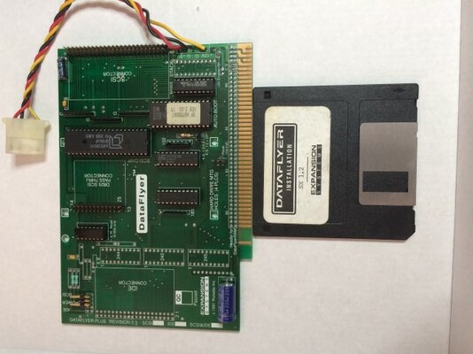

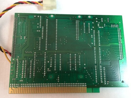

I have for sale this Dataflyer Plus Scsi card.
I have tested only on my 3000T Amiga, the card was detected by early start menu and on witchamiga, but i cant see any HDD on system, Only the HDD connected on 3000T onboard Scsi.
So i will sell this card as not working
Price: 30€ + 6€ (Registered Shipping) + Paypal fees
Now: 23€ + 6€ + Paypal fees
Regards
Pedro

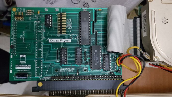

I also have the same card and also the ZORR II adapter. I replaced all chips including the AM5380PC SCSI BUS Controller but nothing, the system does not see the HDD. The card is recognized by SYSINFO as "DataFlyer 500". I also reprogrammed the eprom with new ROM v2.1 and still nothing. I assume, at this point, that it is the TIBPAL16L8 (ROM containing control logic and read protected) which is faulty and that is why I want to try with a working PAL. Bye

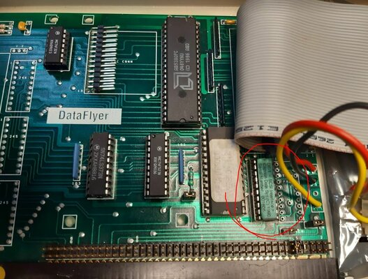

for info, I burned two "Lattice" branded GAL16V8s with the "jed" file posted, but it doesn't work.
The card is not recognized. Attached photo of my card.
