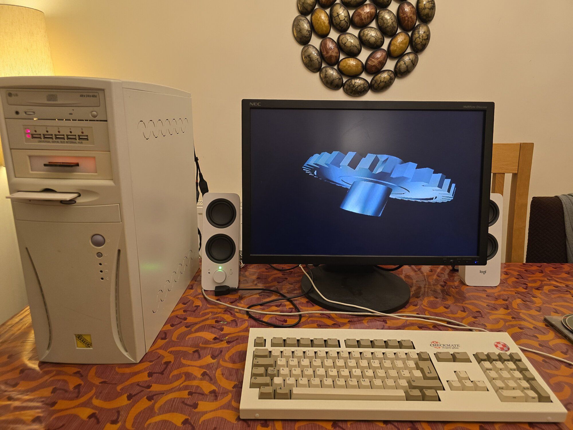

So recently the machine just stopped booting or powering up. As I mentioned above a new PSU seemed to have fixed that, but as soon as I congratulated myself on sorting that, other things started going wrong.
Firstly it would not boot - it clearly did the first boot, then blizzkicked the rom but then would not load to wb. After some messing around it became apparent that removing the USB PCI card seemed to resolve this. Now from memory (don't know how true this is) the mediator needs the graphics card in the fourth slot and the network card in the first. so I tried switching the sound and USB cards around in the middle slots, but testing showed that as long as the USB card was not there in any slot, the machine booted fine with the soundcard in either slot.
Hmmm, so I ordered another cloned spider card from ebay.
Whilst waiting for this, the CD drive went mental one day sounding like it was trying to take off. Thereafter it would not recognise any CDs although WB could see the device etc. AND also then my checkmate a1200 keyboard died. As far as I can see the Keyrah inside is dead. I have tried changing cables and using it with my actual checkmate amiga (which has its own identical checkmate keyboard) and the process of elimination and swapping things around points to the Keyrah.) I am currently using an old A4000 keyboard that has some dodgy keys (improved by various cleaning and lead pencil tricks but still not as good as I want) and a spare PC USB keyboard.
New (well, you know what I mean) CD drive arrived from Ebay and is fitted and works, however I am sure the old one used to reduce the bootup delay significantly but this one doesn't, which is mildly annoying - I wonder if I remove scsi.device from the rom if this will solve it - the CD used atapi.device and the SCSI Kit uses its own device driver as well. Maybe I will try that.
Yesterday the new USB card arrived so fitted that, and it made no difference.....but, the machine will boot to safe mode, and so I started tracing the startup. Anyway, after lots of testing I ended up trying the old USB card and despite me not changing anything it now seems to work again. I have no idea. After all that maybe it was a loose connection?
I am going to close this up and put it back upstairs with the outstanding issues of sorting a better keyboard and the long boot delay - (assuming it still boots after I have moved it!)
