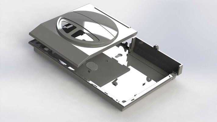

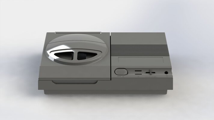

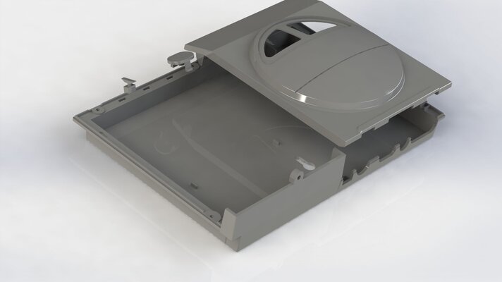

Now there is also an Amiga CD32
I am now waiting for some 3d-printed parts to confirm that it can be assembled.
Anyway, the files are already available.

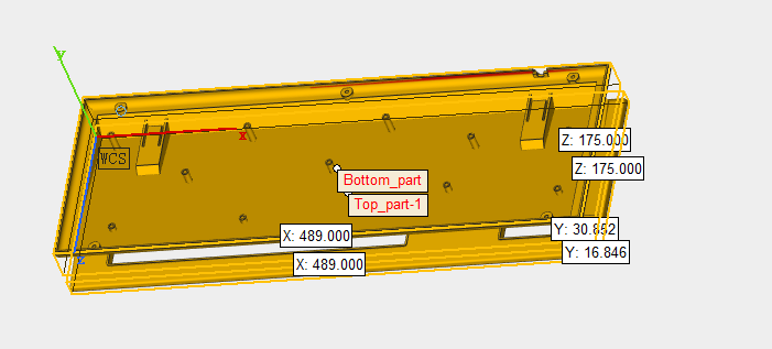

Hi, about this A4000 keyboard case design, After buying the files from you, and submitting them to JLCPCB for printing, they have come back to me warning of a very high probability of warping due to the design. Can you confirm you or anyone else has had this printed successfully? This is what they have said:

the parts has high risks of deformation and warping because of the geometry, will this risk be acceptable for you? Shall we proceed as per your files?
Usually, for flat parts, frame parts, enclosures with no strong ribs inside, and large unoccupied areas parts, and the models could be shrinking to the center and warping to the diagonal lines and edges. Kindly recommended that it is better to increase the thin wall thickness at least 3.5mm ,and add strong ribs to strengthen the structure of the parts.

Hello
They always reply something like that. They are usually not responsible for small defects so they ask something like that. Usually their quality is reasonably good anyway. If something is bad(scratches, holes etc) they warn about that with pictures after the printing.
Take a look on Amiga 1200 pictures before, they printed that case. It is as huge as this keyboard. And its important that such huge parts are anyway much more deformable than small ones. Generally, FDM printing gives more stable results but the quality of the surface is much worse.
