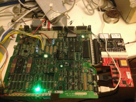

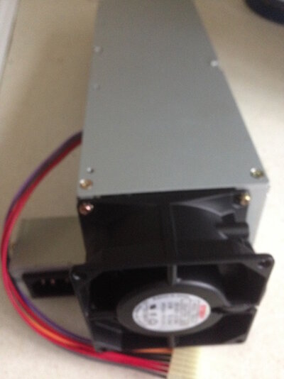

but no A1000 PSU , ill hot wire a pico PSU ...dont like that , ill hot wire an A2000 PSU as it has the tick signal...ok.
i changed all the socketed chips again from a working 500 , except Agnus. No joy here.

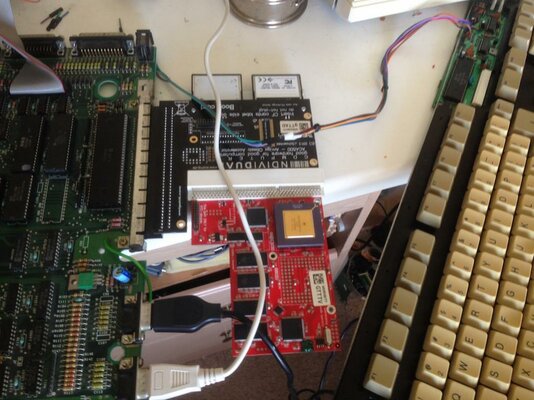

i then fitted a kickstart adaptor that i borrowed about 4 years ago ....must return it, that didn't work either but i did get a faint beep at power up.
now i had no boot up sequence of lights, no kickstart , zip...just a black screen but a quiet beep.
i tried other kickstart in the adaptor but either nothing or quiet beep.
So maybe its ROM related , the power light flickers too?

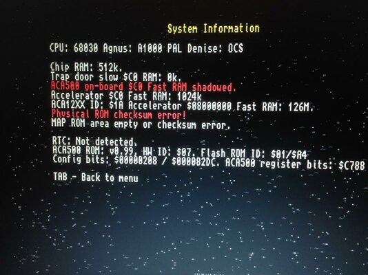

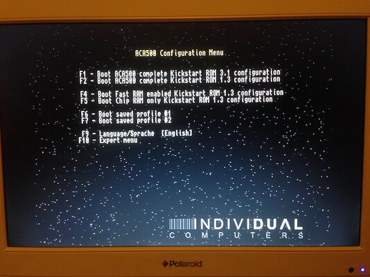

i removed the kickstart adapter and put it back as normal ...and nothing,its dead. So what if i try the ACA500 either though Jens says do not fit it. the pinouts are the same on a500/a1000 just incorrect orientation.

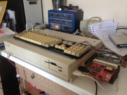

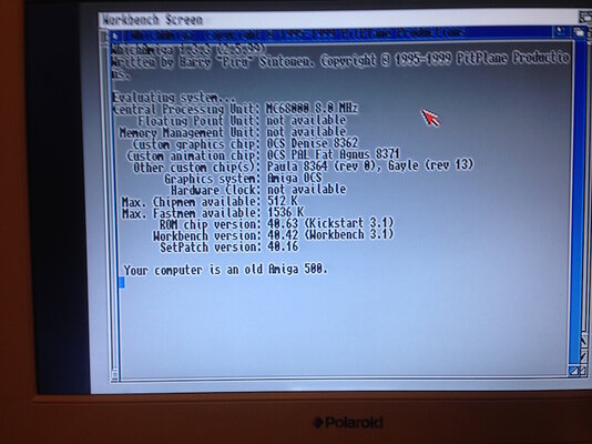

and bingo it lives! , I've hot wired an A500 keyboard on to the 1000 for the moment. Data, clock,gnd,+5v

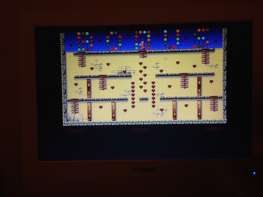

video & audio all good.

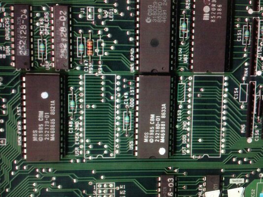

So whats actually wrong? well the kickstart ROMs (79,80) are dead i think , I've ordered two more from Germany but its alive...first time in 4 years
MOS
252179-01
©1985 CBM
5185 TAIWAN
28005A-0054
MOS
252180-01
©1985 CBM
5085 TAIWAN
28005A-0055

ultimately I'm going to rehouse this in a good A1000 case , clean up the keyboard and make a pretty A1000 and plonk an big heavy commodore CRT screen on it

A1000 PSU connector (motherboard end)
1 * -5v
2 * +12v
3 * GND
4 * GND
5 * +5v
6 * +5v
7 * tick sync

A2000 PSU pinout
YYYYBBBBO RGWU
U=Brown wire
gap = missing wire in connector
or
1 +5
2 +5
3 +5
4 +5
5 GND
6 GND
7 GND
8 GND
9 +12
10 no wire (keyway)
11 -12
12 +5 USR
13 -5
14 TICK
