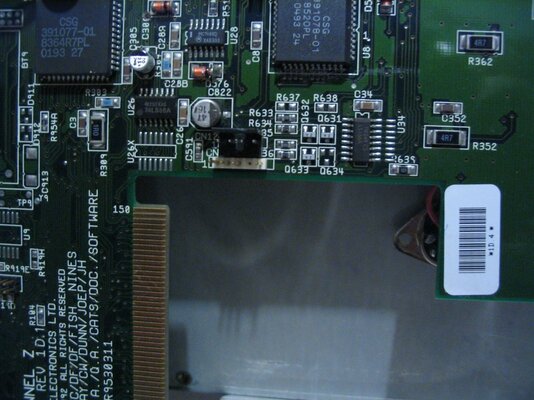

Another thing I just noticed: This board is somewhat unusual. It has a rev 1D.1 PCB, 9252 date, but has a sticker that says 1D.4. The long wire-bridge found in 1D.1 but not found on 1D.4 boards is there, so I'm not sure what to make of the sticker.
It looks like that's the way the board left the factory. I'll check for the actual modifications as documented in BBOAH, but is this 'hybrid' a known case?

Here you go - four 6 megapixel images covering the area of my A1200 1B mobo. http://npandd.co.uk/A1200_1B
Funny how you can sometimes spot things in photos that you don't notice looking at it normally - like how dusty it is! Also that patch wire on a chip near the composite out socket - any idea what that's for? (No idea if that was done by the previous owner or if it was shipped like that.)
@Zetr0
Photos as requested :p. My hybrid must be more of an 1D.1, it doesn't have the XC1 capacitor installed like all 'proper' 1D.4s I've seen. It has a 22-pin clockport though, while I've seen a 1D.1 photo with a 40-pin clockport, exactly like the 1B. Yet here's another 1D.1 photo which could well have been my own (even same 9252 date), but the sticker reads 1D.1 here. Go figure.
The schematics even mention an 1C revision somewhere! And I'm pretty sure someone here has a 1D.2 board (TheCorfiot?) I think I saw a photo of the "1D.2" silkscreening in a thread.
EDIT: Replaced separate silkscreen & sticker photos with one that spans both spots.

The wire mod is by Commodore, see here. It's a bit fuzzy but you can see the same brown wire. You can also see a budgie wire-fix which isn't present in your 1B, also not present on yours is the XU1 IC. 1B is uncommon, yours is even more :p
Also the broken resistor R321 that puzzled me because on my boards (1D.1 & 1D.4) it was an 681 (680 Ohm) while in the schematics it was mentioned as 1.5 K... it's indeed an 152 (1500 Ohm) on yours! That kind of un-puzzles me. Of course why they changed it on later revs is beyond me.

Ah - that's interesting - I wondered if it were the previous owner's handiwork!
LOL - so what does XU1 do?
Hehe, trust me to be out of the ordinary.
Maybe its actual value isn't critical and they had a glut of 681s? :lol:
